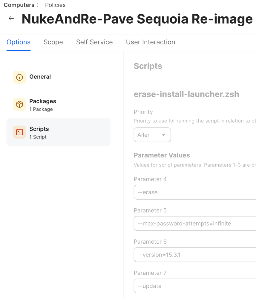

@bet4test3r Add it as a Script payload to a policy with the erase-install package. The script payload parameters to do an erase will look something like this:

Yes I used this script. But iam not sure how exactly should a policy look like. Just add this script to the policy without the erase-install package or with? Any other things to be aware?
Posted on 04-30-2025 06:11 AM

2 weeks ago
My only use for erase-install will be for erasing and installing macOS using Self Service. This will be a tool for my support staff. I used the arguments provided above by @sdagley . They worked great. I have run several tests logged in as an admin user and a standard user. I specified macOS 15.5 but I want to have this download what ever the current macOS is instead of having to specify what version to use. It looks like using the "--update" argument does that so would I need to add the "--version=" argument? I have not yet tested doing this without it.
2 weeks ago
@howie_isaacks Use the "--os=MAJOR_VERSION" option and it'll get you the latest release of whatever macOS MAJOR_VERSION is (e.g. "--os=15" will currently get you 15.5)
