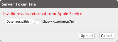

Hi all,
I'm having issues updating the DEP Token in the JSS. I always get the Error Message "Invalid results returned from Apple Service.
All the Terms and Conditions are accepted, Time on the JAMF Server is correct. Does anybody have i hint to what is going wrong here? Any help appreciated.
Posted on 10-25-2017 08:23 AM
Solved by creating a new Device Manager Account in School Manager. Everything worked fine with the new Account.

Posted on 02-09-2018 02:13 PM
Just wanted to note we had this same issue as well. And sure enough a new Device Manager account in School Manager worked fine. We didn't have a ton of accounts so we just ended up creating new accounts. I thought I would still talk to Apple support to see if they had heard about this issue, and if they had not I wanted to let them know about it. They had never heard about this issue. They did log it and create a case number. My guess is most institutions that have converted over have not had to create a new token yet so they haven't seen this, as everything else works just fine with those ported over accounts.

Posted on 02-13-2018 11:40 AM
I've confirmed that if you de-activate an account that DEP tokens where created on you will then get an error in Jamf of :
“Unable to contact https://mdmenrollment.apple.com to get the list of devices”
If you re-activate that account in ASM and then do a refresh in Jamf on that DEP instance it will start working again.
Very odd as I would have thought the token was more for the institution and not the creator of the token.
Posted on 10-30-2020 06:12 AM
Deactivating and re-activating my account fixed it for us as well! I was getting the "Invalid results returned from Apple Services" error as well. Just wanted to let people know this is still sometimes and issue and that still fixes it!
