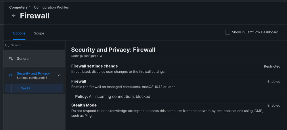

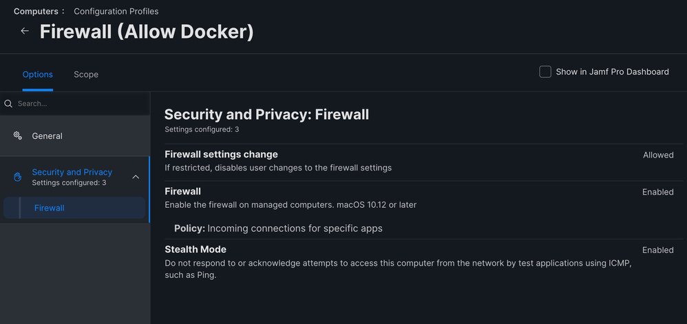

I've created a Configuration Profile called 'Firewall - Allow Docker,' which permits changes to FW settings, as shown in the screenshot where I added my computer. Additionally, I added an exclusion for the same laptop in another profile named 'Firewall' where changes are restricted. Despite these settings, the firewall is still locked.
I'm new to Jamf, having worked with this product for only a month. Could there be another location where the FW policy is defined?
Screenshot 2025-01-03 at 12.01.19 AM.pngScreenshot 2025-01-03 at 12.01.33 AM.pngScreenshot 2025-01-03 at 12.02.57 AM.png
If you enable the Firewall setting then it will force the firewall to be on regardless of the "Firewall settings change" setting. If you want to have an exception for Docker then you need to enable the "Control incoming connections for specific apps" option and add Docker (with Bundle ID of com.docker) to the list of specific apps.
