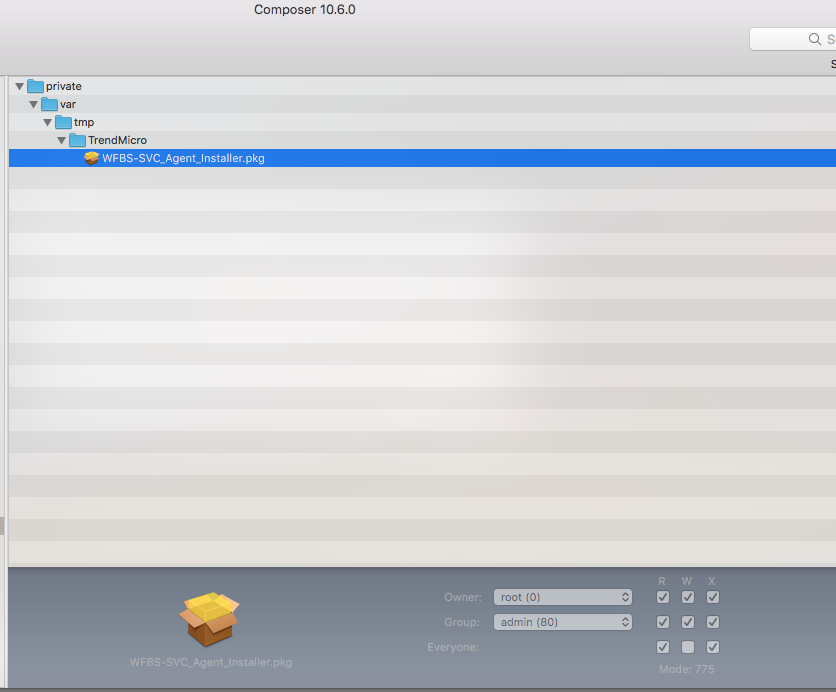

@CorpIT_eB I did use JAMF Composer to package this. What we found was Trend's documentation for mass deployment needed a little T.L.C for JAMF. I'll break down the steps we took to get this working for us.

@mack525 Man this is perfect but I am using Composer 10.11.0 when I download the WFBS installer and I open Composer how do I create the .dmg file without the snapshot I would have to create a snapshot first to accomplish this correct?
Posted on 04-18-2019 01:15 PM
@CorpIT_eB Yes. You can run a snapshot and then modify it.
Posted on 04-18-2019 01:33 PM
@mack525 I am apologize man can you give me a bit of clarity on how you got your results on step one.
On my end when I open composer (using snapshot) I take the installer and drop into /var/tmp/TrendMicro (had to create this folder) from there I ran the installer and then capture but when it comes back to me the sources reads user, libarary, users, applications do I delete or modify any of these files as the user here is clearly not the user that would be on future machines.
From here build a .dmg and then?
If you have a simpler way of doing it please let me know I think if I get this final piece of the puzzle I might be able to get this working on our end as well.
Thank you for everything!!
Posted on 04-18-2019 01:34 PM
No need for a snapshot for that.
Just open /private/tmp/
in the Finder and create a folder in it called "TrendMicro" and then copy the installer into it. Then in Composer, drag the "TrendMicro" folder (not the .pkg) into Composer's sidebar and it will copy it in and create a new source. Done.
Also, it shouldn't be a requirement to build it as a dmg since it's just dropping the pkg into that location. Unless it's just not shown in your screenshots, I don't see anything that would need the FEU or FUT options enabled. A package style installer will also do the job, but either one should work fine for this.

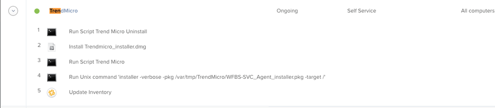

@mack525 Toss me you a screen shot of you your Uninstaller script as well so I can save it for the future.
Posted on 04-18-2019 02:07 PM
Posted on 04-19-2019 07:20 AM

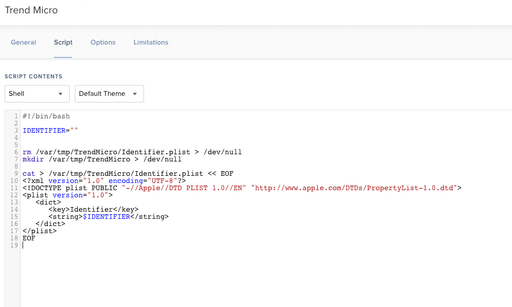

@mack525 The Uninstaller script works flawlessly.
However the installation portion of it still fails to complete. (No ERRORS) && No Trend Icon or Application in site.
IDENTIFIER="pulled from trend"
rm /var/tmp/TrendMicro/Identifier.plist > /dev/null
mkdir /var/tmp/TrendMicro > /dev/null
cat > /var/tmp/TrendMicro/Identifier.plist << EOF
<key>Identifier</key>
<string>Your Identifier</string>
EOF

Executing Policy WFBS TrenMicro Installation
Downloading https://use1-jcds.services.jamfcloud.com//download/19727f945eb74fb797d9d257fa52498e/TrendMicro.dmg?token=downloadsatoken
Verifying DMG...
Verifying package integrity...
Installing TrendMicro.dmg...
Closing package...
Running script TrendMicro Installation...
Script exit code: 0
Script result: rm: /var/tmp/TrendMicro/Identifier.plist: No such file or directory
mkdir: /var/tmp/TrendMicro: File exists
Running command installer -verbose -pkg /var/tmp/TrendMicro/WFBS-SVC_Agent_installer.pkg -target /...
Result of command:
installer: Package name is Trend Micro Security Agent
installer: Upgrading at base path /
installer: Preparing for installation….....
installer: Preparing the disk….....
installer: Preparing Trend Micro Security Agent….....
installer: Waiting for other installations to complete….....
installer: Configuring the installation….....
installer:
installer: Running package scripts….....
installer: Validating packages….....
Running Recon...
Retrieving inventory preferences from https://mycompany.jamfcloud.com/...
Locating package receipts...
Locating accounts...
Locating software updates...
Searching path: /Applications
Locating printers...
Locating hardware information (Mac OS X 10.14.4)...
Gathering application usage information...

Ok @mack525 so now it's giving me this.
Downloading https://use1-jcds.services.jamfcloud.com//download/19727f945eb74fb797d9d257fa52498e/TrendMicro.dmg?token=downloadedtokengoeshere
Verifying DMG...
Closing package...
Script exit code: 0
Running command installer -pkg /var/tmp/TrendMicro/WFBS-SVC_Agent_installer.pkg -target /...
Result of command:
installer: The upgrade failed (The Installer encountered an error that caused the installation to fail. Contact the software manufacturer for assistance.)

@mack525 I got it to work, i revisited the script and was missing syntax, Once I fixed that it worked like a charm.

@mack525 I had forgot to re-activate the variable for the IDENTIFIER so essentially what was happening was that the installer would run try to find Trends ID and then error out. It was not evident to me till I relived the script and caught the syntax error.

@achristoforatos in my case it was at the string the variable was off. Went from
<string>$youridentifierhere</string>
to the proper string and variable of:
<string>$IDENTIFIER</string>
And I only caught it because, this was a piece of a much larger script.
Posted on 05-31-2019 01:36 PM
So at the top of the script where IDENTIFIER="" I should place my identifier there then place $IDENTIFIER where you've placed it?
Posted on 05-31-2019 01:41 PM
@achristoforatos That is correct. Essentially the ID comes from TrendMicro. you copy and paste that in between the "" so it will look something like:
IDENTIFER="oiwdhcwjnbephrw12w34iodshfphpodhpdncpoe"
So when you call it in the string $IDENTIFER it just grabs the ID.

IDENTIFIER="TrendMicroIDgoeshere"
EOF
