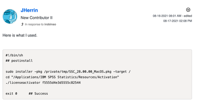

I have had success with scripts to insert the auth code for SPSS in past but SPSS 30 will not apply code through script. Popup still comes up. Script that used to work was this one. I have tried few option using the SPSS instruction manual but no success. What's working for you all?

you might want to bin that image while you can? if its a real licence?
Posted on 03-20-2025 10:07 AM
I believe this is a fake code added but the contributor, I copied the image from a post in Jamf nation and someone said the same thing to him and never changed.
