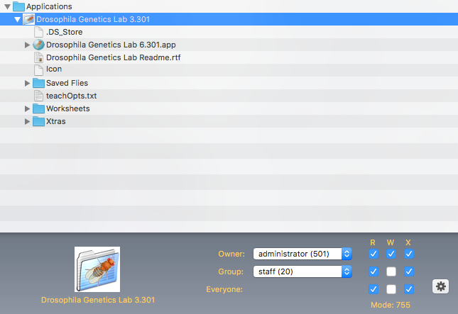

I cannot for the life of me figure this out. I've got an Application I put out on Self Service that won't allow students to open it. I used Composer to create a PKG (and a DMG) attached it to the policy. It installs no problem, Applications is whitelisted and other Apps work. When they try to open it, it says they don't have permissions to open the application. I'm not sure what else to try here.

Ok, I didn't look close enough before, but in your first screenshot of the permissions on the app itself, it looks like only "administrator" can open it. There need to be checks for the staff group at least for Read and Execute (R + X) If not, only the account "administrator" can execute the app bundle. You should probably also set Everyone to the same permissions as staff.

Did you make any adjustments to the permissions on the app itself while in Composer? Generally speaking, it's a good practice to examine the permissions on the app inside Composer and make any adjustments to make sure it's not set in a way that only one user has access to open it.

I've attached two screenshots of the current permission settings.
Posted on 03-29-2017 01:26 PM
That was it, darn permissions. To be completely honest I didn't know you could edit the permissions in Composer. So that's why I'm probably having so much trouble with some Apps.

So you know also for the future, if you look in Composer, that little gear icon to the bottom right of the permissions setting is something you'll want to look at as well. Another way to fix this would have been to click on the enclosing "Drosophila Genetics Labs 3.301" folder and then click that gear icon and choose the menu item called "Apply Permissions to <folder name> and All Enclosed Items" This does a recursive permissions adjustment, making sure every item under that directory have the same as the directory itself. I say that because in your 2nd screenshot, it looks like that enclosing directory had the correct permissions.
