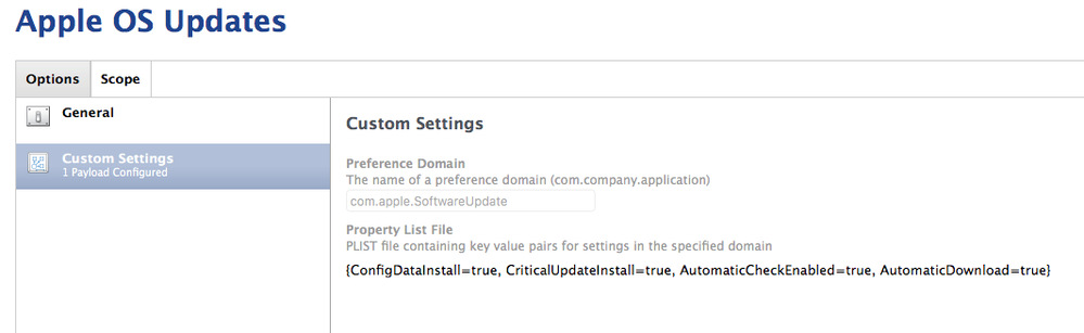

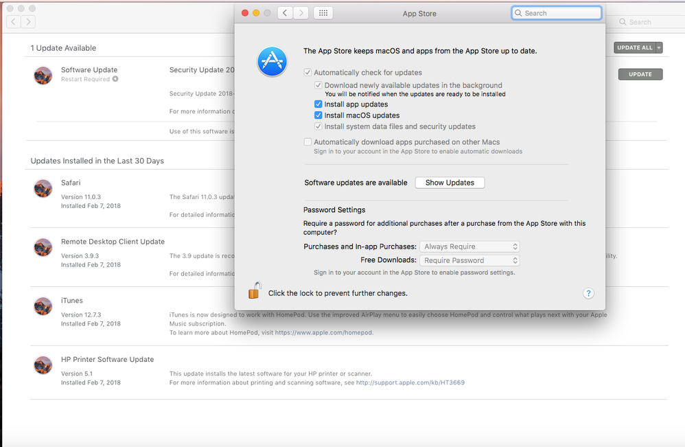

I created a configuration profile for automatic OS updates and pushed it to a test 10.12 client. After restarting the client and logging in, it automatically updated safari, remote desktop client, itunes, and HP printer software. However, it did not install "Security Update 2018-001 10.2.6".
What am I overlooking to get security updates automatically installed?

I believe this update requires a restart.
Until Apple provide a mechanism to force a Mac to run its latest OS build, part of an Apple consumer-like experience with regard to patching and updates is some form of reminding, nagging, or forcing periodic restarts, especially when restart-required updates are pending.

It is a notebook, but it is connected to power. I realize it does require a restart, but I was hoping it would at least install.

@mccallister macOS updates that require a restart install at restart. They cannot install in the background.
On the currently supported macOS versions (10.11+), when App Store preferences are configured as you've described in the original post, updates that do not require a restart are automatically downloaded and installed. Updates that require a restart are downloaded and cached. Once cached, macOS displays reminders in Notification Center urging the user to restart. The update(s) will install at the next restart.
The methods I described in my previous post are useful when the macOS Notification Center reminders are ignored by users.

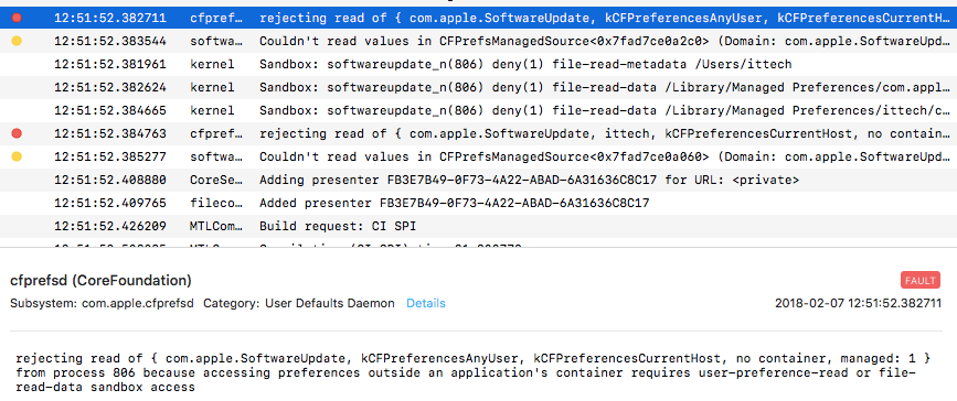

It never did do the security update after a restart. It looks like this method may not be a viable solution anyway because it did not do any updates at all on a 10.13 client. See errors from console. Back to the drawing board I guess.
Posted on 02-07-2018 10:56 AM
That looks like some sort of permissions issue. It's doesn't appear that software update is failing, but rather, it's not able to read its preferences. I'd suggest examining how those preferences are being set and anything else on the Mac that may be affecting cfprefsd. softwareupdate, or the files these tools need to reference.

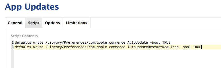

we use a similar profile along with a profile for an internal SUS and the update installed. What you could do to test , would be to get a machine that is setup the way you would like it to be. Grab the plist and use mcxToProfile to generate the mobileconfig. Upload and test. This was on 10.12.6
