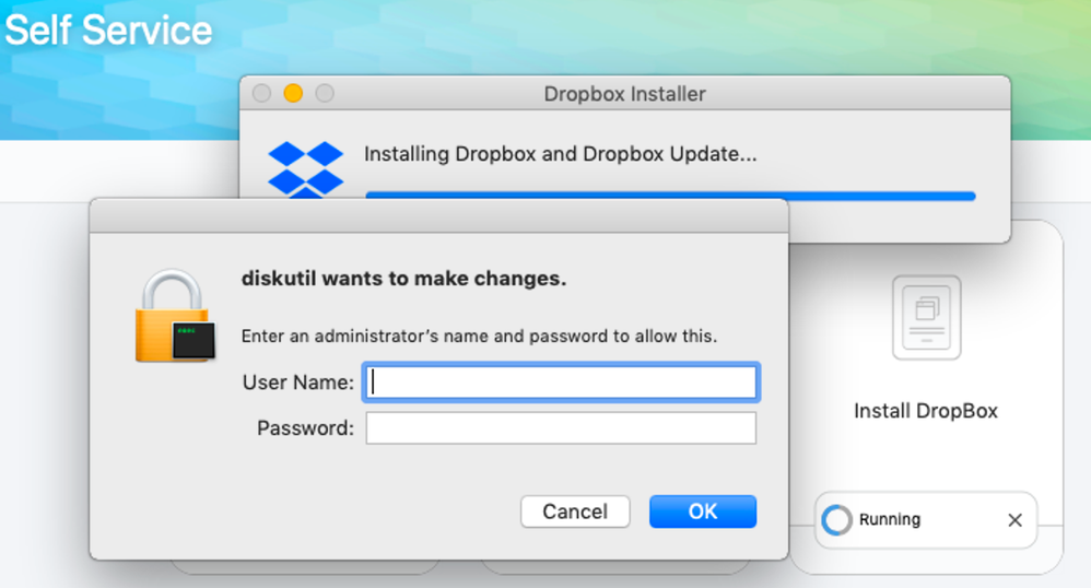

Hi. Tying these scripts on our standard users and during execution in self service diskutil asks for the admin password. Dropbox does seem to install then the Dropbox disk image also cannot be unmounted unless you enter the admin password. We are on Jamf 15 and MacOS 10.14.6
fcfbe7a0346b4bf89b860d2d228224d1
ctw
I'm also getting the diskutil error or the installer is just crashing and not letting me continue.

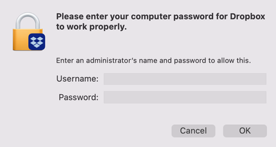

agetz
I think there is an issue with trying to install with the self updating version. I am currently working on using the 'offline' installer which looks to be the full app so I have it packaged up to put it in the applications folder. Happened upon the windows version and dug around for the mac version. Hope this is helpful.
https://www.dropbox.com/downloading?full=1&os=mac

cjavallas
@KretZoR   I am using your sctip during provisioning with depnotify and notice a pop up claiming :
Dropbox needs to change permissions for the Folder: /var/root/.dropbox
I understand the script is running as root and assume dropbox is trying to setup for Root user...  but wondering if there is a way around this?

mline
This one prompts me for admin credentials post installing and launching :(
KretZoR
Hi @mline , please use Installomator script instead. It works and supports a lot of other applications also.
