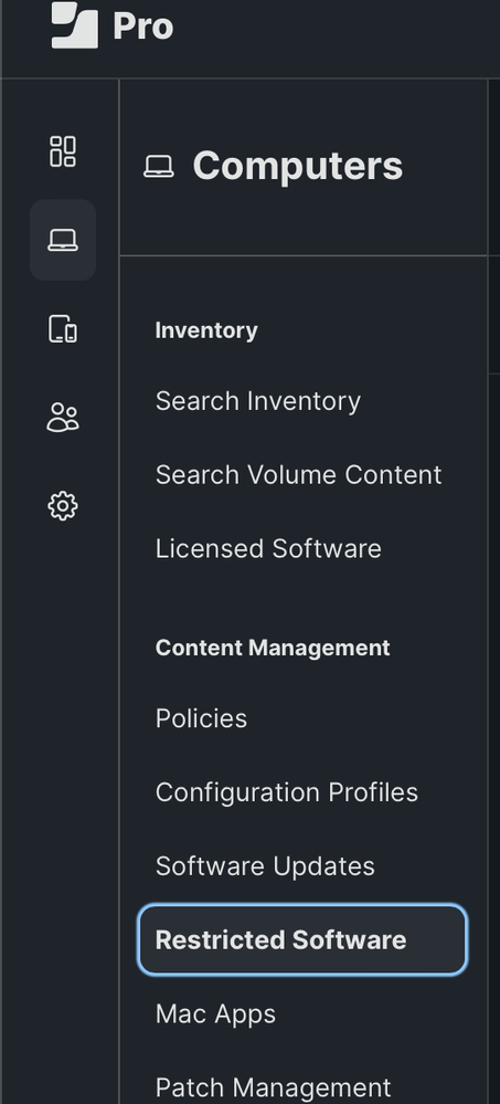

Posted on 08-15-2024 04:43 PM
So, disallowing and allowing app paths in Restrictions payload of Config Profiles doesn't work anymore?
Posted on 08-16-2024 04:28 AM
Are you doing it here?

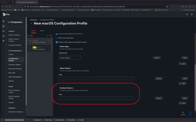

Posted on 03-19-2025 04:50 PM
Responding to this thread since I just did some recent testing in Sequoia.
Technically, all of these keys were deprecated back in Catalina. But some appear to still be working on 15.3.2.
I tried using the 'Disallow Folders' option, specified a couple userland folders (~/Desktop/, ~/Downloads/, etc) - and couldn't get it to do anything. Not sure if I was doing something wrong, but I couldn't get it to work at all.

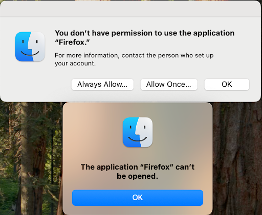

And so far, it seems to work wonderfully. The only thing I've had to add was that Google path on the bottom because the Chrome keystone updater was getting blocked.
As always, test thoroughly before deploying. Currently have a group of testers doing more testing.
Had one where GoToMeeting.app was installed in user-level /Application Support/ - had to move to /Applications/. Between that and adding the Google path, that's been about it so far.
Seems to work pretty sweet. Somewhat similar to Google Santa without all of the setup. Example of the block message:
If you go with the Allow List route, and you download a .dmg somewhere and then mount it, it will block you from running any .app that is inside the .dmg. So it essentially also blocks .apps from running out of /Volumes/ which is nice.
