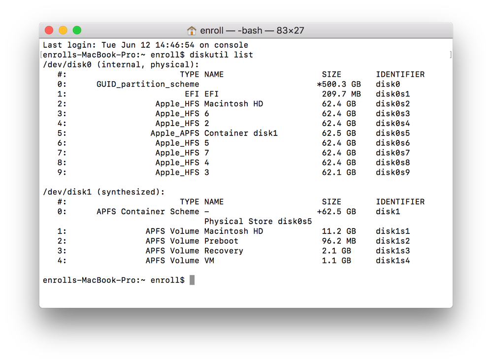

While this functionality does appear to be extremely handy, it has become clear to me that Apple did not see fit to test this workflow with FileVault enabled Macs (big surprise!). While the Self Service policy based wipe/reinstall does indeed wipe and re-install, after ~4 run-throughs (10.13.5 to 10.13.5) on a FV enabled Mac, the OS comes up with 8 partitions (one APFS called Macintosh HD, one HFS+ called Macintosh HD, and others numbered 2-7, all HFS+) post Setup Assistant.
Would some of you FileVault users try to replicate this and report back? The steps carried out are as listed in the blog post, aside from the installer being placed into /Users/Shared (it is our existing "upgrade in place" package).

I've seen similar. It works by creating a new volume and installing the OS to that volume then deleting the old one. So if the process fails you end up with extra Volumes (which are easy enough to delete).
I have alot of trouble with the command running specifically on 10.3.5 FV2ed machines with non-admin users. I'd say 1/4 or 1/5 attempts fails. The error code is almost always just "The Helper Tool Crashed" so I can never really see what went wrong. It just seems to work when it feels like and fail when it doesn't.

Just to add a bit more to this, I've now wiped/reinstalled twice on a Mac that was file vaulted and I'm not seeing additional any additional partitions/volumes showing up. I'm using macOS 10.13.5.

And to add to discussion - after successfully updating encrypted MacBook to 10.13.5 the partition map didn't change for me.
