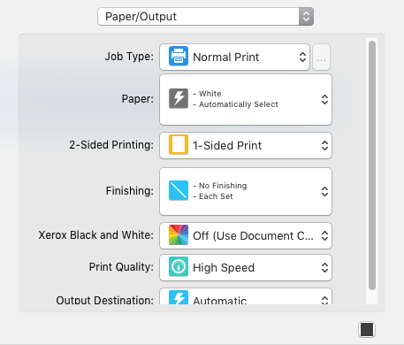

rgerman
Touché
My Xerox...
What a car wreck...
cdfd282ae12f448e96921a1c435a2fe8

It appears the issue has been resolved in macOS Catalina. The Xerox print dialog now appears correctly.
cdenesha
@rgerman What app did you test printing in? Do you see the proper Xerox print dialog in Safari?
rgerman
Safari looked correct as well. I am using the XeroxPrintDriver_5.3.0_2118.dmg from Xerox's site.
