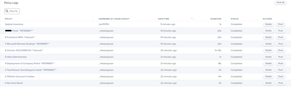

This screenshot shows polices which should run after enrolment complete:
This screenshot shows what policies actually ran:
It almost seems that the change of user from _mbtsetupuser to the user which automatically logs in (JamfVPN in this case), is causing the policy sequence to break and so stops running any remaining policies.

Think I may have fixed it.
In the prestage enrollment we had it set to create a Administrator account pre setup assistant. If I remove this option everything works absolutely fine.
It seems that the policies run as this administrator account. The prestage enrolment then creates the local user (based on LDAP lookup) and automatically logs that user in. The logging in as this LDAP created user interrupts the 'flow' of the policies started by the administrator account.
I have verified this by making the changes to the different prestage enrolments we have and also by wiping and reinstalling 4 macbooks. All work fine after removing the creation of the pre setup assistant administrator.
**After further testing there still seems to be some strange behaviour. Looking through the logs it also looks as if the check to run policies on login is causing this to also fail. I rebuilt one device and as soon as the automatically created user logged in I noticed within the Jamf.log that all enrolment complete triggered policies stopped. I have unticked the checkin option and am in the process of rebuilding this Mac now to see if it fixes it. It seems that the user logging in causes this break in the flow. Has anyone else experienced this at all?
