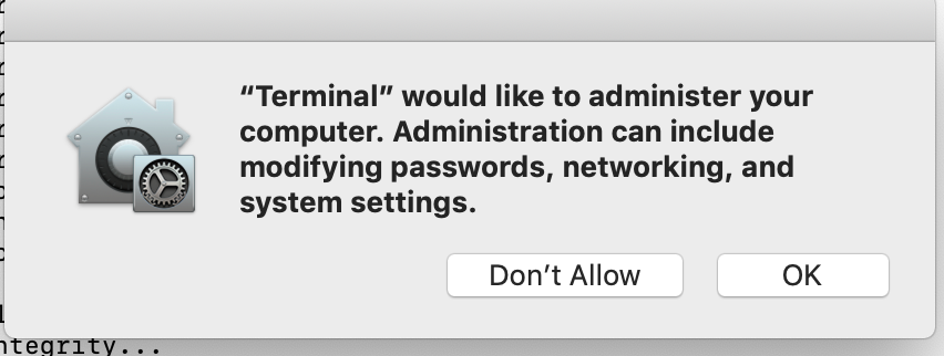

I then deployed the profile and the CyberArkEPM but when I deployed it to the client, it still prompt for user interaction approval.
Need your suggestions.

This is message that I received during the installation.
Chuey
@thuan Seems like you'd have to use the PPPC Utility to whitelist terminal I suppose.

Any package where you need the bundleID and Team ID. Open the package on your machine and click the padlock in the top right. Id's are there.
summoner2100
To figure out what it needs to allow. Install on a test machine, and manually approve the system preference option. When it shows in the list, right click and it should give you an option to locate in finder. Drag that into PPPC utility. You should be done.
