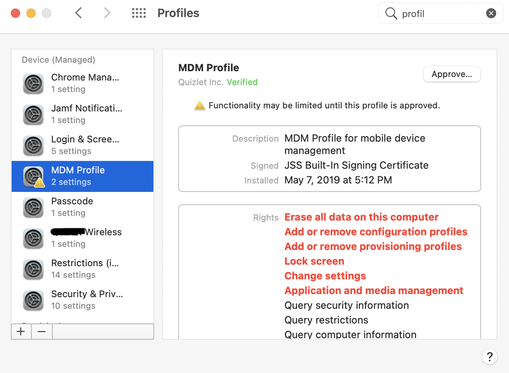

Script result: profiles install for file:'/tmp/test.mobileconfig' and user:'root' returned 13 (The profile must originate from a user approved MDM server.)
Any ideas?
@rpayne Deploy the profile from Jamf Pro as a Configuration Profile instead of a scripted install. Some profiles such as kernel extension and privacy approvals can only be installed via MDM. There is no other option.

When I've seen the message "The profile must originate from a user approved MDM server" it typically means that the user needs to approve the profile within System Preferences > Profiles.
