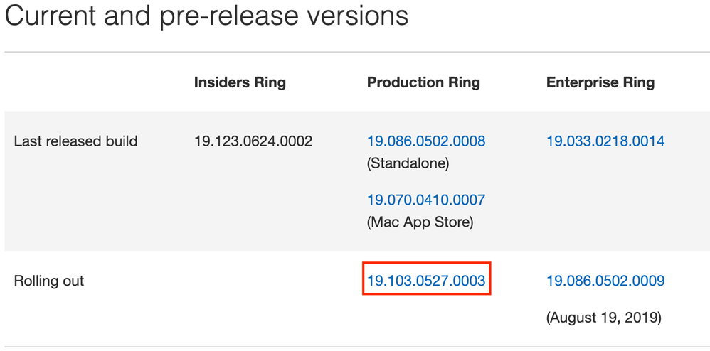

I know it's not a priority compared to other areas of Jamf but the Patch Management Definitions for OneDrive aren't aligned with the OneDrive release cycle (Insider, Production, Enterprise) which Microsoft are working to:
90359f20700e48c2b5c98a3adc036532
Patch management is currently reporting 19.086.0502 as the current version however 19.103.0527 is currently deploying to the Production ring and virtually all my fleet is now reporting an unknown version in Patch Management.

We get our information for OneDrive at this location: https://support.office.com/en-us/article/onedrive-release-notes-845dcf18-f921-435e-bf28-4e24b95e5fc0?ui=en-US&rs=en-US&ad=US
We use the Production Ring, Rolling out, version for the definition. It's been this way since the definitions inception. Here's the problem we're seeing here at the moment, 19.103.0527.0003 is the version that's currently being shown. However when trying to download that link it still gives us 19.086.0502.0008 - the previous latest version. We've been watching this for about a week straight waiting for the link to be corrected or for https://macadmins.software to show version 19.103.0527.0003, which it hasn't yet.
Our stance is that we typically will not release an update for a Software Title unless we are able to download and test it via the Quality Assurance department prior to the release. So at the moment we're being held up because we cannot get a hold of 19.103.0527.0003.
Do you have a public facing link to the latest version that you can share? If there is a more accurate place to check for OneDrive updates we can use that for updates instead.

The download link for 10.103.0527.003 is here - I obtained it from the page you referenced (it's hyperlinked from the version number):

If only it were that simple right? Every time myself and a coworker download and install from that link we are still getting 19.085.0502. Clearing cache or using incognito doesn't make a difference. I've enclosed a gif. If this is where you obtained version 19.103 I'm curious if they pulled it and then will release it at a later date. If you have another public facing link I would appreciate you sharing.

Have to admit I hadn't viewed the .pkg to check the contents but I think I've worked out what's going on...
When the standalone version of OneDrive is installed, it also includes a standalone updater daemon which is getting immediately launched (courtesy of a LaunchDaemon) and is then pulling down the Rolling out version from the Production Ring.
I've not managed to find any links that are hosting the Rolling out version but will keep searching.
I've reached out to Jonathan Leung on Slack (he's a Program Manager for OneDrive at Microsoft) outlining the issue to see if he can offer any assistance as he's been pretty helpful in the past.

OK, the .pkg is available here
The static public facing link updates once the release is fully rolled out so for early access Jonathan says we should just be able to substitute the version number in the URL to access the relevant version.
