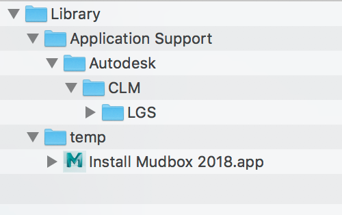

jthurwood
I edited @mscottblake original script to work with Maya/Mudbox 2018. It installed but didn't license correctly.
Can anyone see what i've done wrong?

edullum
@colleen_keenan I'm getting something similar... I have installed Maya 2018 and Mudbox 2018 via the instructions in this thread, and then ran the post install script on both applications. When I go to launch the applications, the icon bounces on the dock and then goes away. The application never opens. I have verified from the JSS log files that the install was successful without any errors.
edullum
@colleen_keenan I figured it out. Both with Maya and Mudbox. When I built the package in Composer I included the license within the Library/Application Support folder (screen shot attached)
5566d10aa24f4a79ad7bcd90c508fc8d
Then, I was running the big postinstall script from @mscottblake. The log files said everything ran successfully, but then Maya and Mudbox would just bounce on the dock and close when I clicked on it. When I really thought about it, the license was already applied within the package I created, and then again when I ran the script. I omitted the script and created a new one to just install the application:
/Library/temp/Install Mudbox 2018.app/Contents/MacOS/setup --noui
Then I created an "activation" policy scoped to a smart group with criteria of Mudbox 2018 Installed. I added a Files and Processes payload and filled in the Command Execute portion with the following info:
/Library/temp/Install Mudbox 2018.app/Contents/Resources/adlmreg -i S #### #### 2018.0.0.F ###-######## /Library/Application Support/Autodesk/Adlm/PIT/2018/MudboxConfig.pit; /Library/temp/Install Mudbox 2018.app/Contents/Resources/adlmreg -i S #### #### 2018.0.0.F ###-######## /Library/Application Support/Autodesk/Adlm/PIT/2018/MudboxConfig.pit
Yes, you are seeing that correct. I ran the command twice. And here is why: When I ran the command on a machine locally, I received an message: "Serial Number doesn't exist. Call setSerialNumber". When I re-ran the command, it was successful.
This site was extremely helpful: https://www.moof-it.co.uk/technical/deploying-autodesk-maya-2018-with-jamf-pro/
