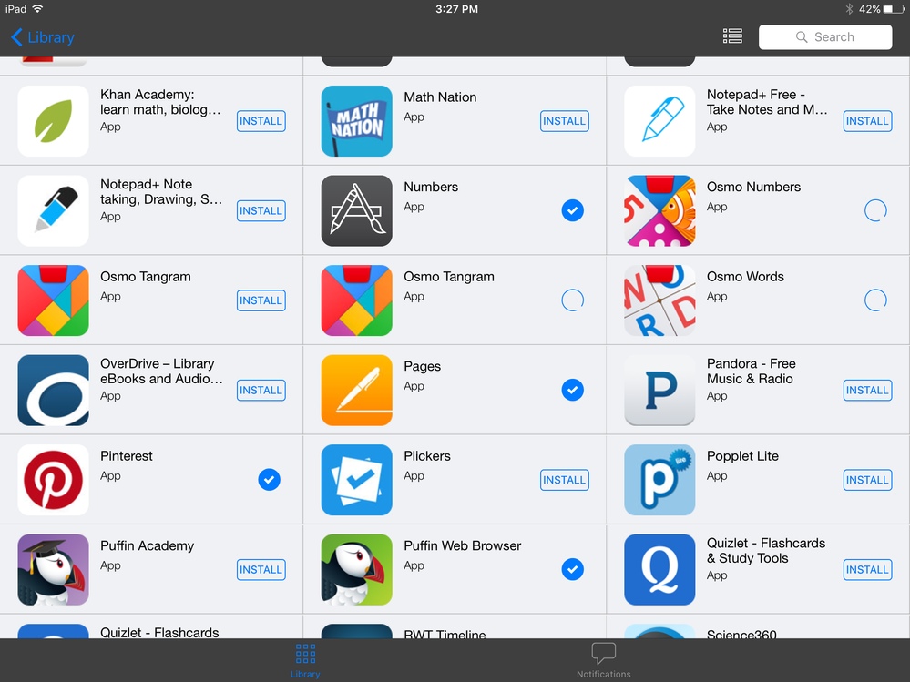

Primary education environment; Managed Apple Id's. 1:1 distribution. Loaded Osmo app into JAMF from VPP. Distributed to specific user. But I'm having an issue getting Osmo app to load from self service on to teacher iPad. Will not load, I get an error message with "This Apple ID can not be used for purchases"
I then tried to assign app to the device to no avail....
Please help me!

Thank you for your assistance! I did check the VPP acct under the VPP tab. Then on the iPad the "install" buttons" in self service just spin
Any other advice? I've been struggling with this for a week.

@Sandy Thank you for your response. I'm learning through this troubleshooting process so thank you for your patience with me. I thought about all of those things and this is what I discovered.
3 pending 9 failed ... but why?
that should be enough space right?
I do have the app scoped to single device.
I pushed 2 apps to another teacher yesterday and he confirmed that they are on his iPad.
