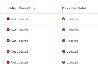

Here is an example of the details in Device Onboarding  in Microsoft Purview with the error messages before and the more informative messages after I have created the configuration profiles in JAMF from the above guide:
View under Device Onboarding:

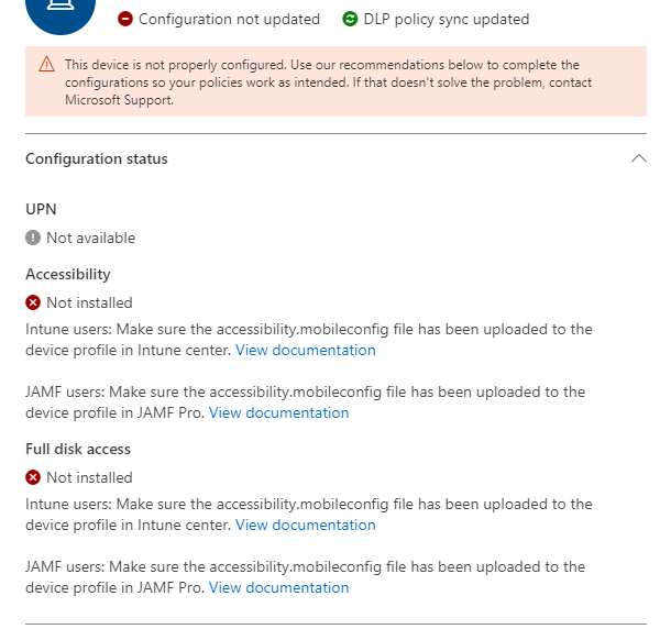

Before the configuration profiles were updated:

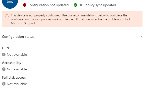

After the configuration profile was updated:
In the documentation that I linked to near the top, there is a "Before You Begin section which mentions this (formatting mine for clarity):
We are managed through JAMF Pro, but we don't use JAMF Connect and they don't seem to have a UPN as shown in the screen shots above. I suspect this is a big part of the problem - but not sure how to fix it. Or am I incorrect and this is a red herring to some other problem in the Configuration Policy/settings/PPPC in JAMF Pro? Maybe both?
