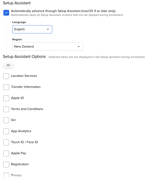

In a PreStage Enrolment, the setting "Automatically advance through Setup Assistant" is not compatible with the "Setup Assistant Options" below it, leave them turned off, otherwise the advancing process will trigger a shutdown or restart when it expects a missing window to appear. i.e.
I also had a shutdown on a MacBook M2. At first it did a complete shutdown.
I followed your instructions, so I left all the options below "Setup Assistant Options" unchecked. Now it doesn't shutdown, but it does a restart. So this seems not to be the only reason for this unexpected restart/shutdown.
To supplement my previous post: When also unchecking all of the configuration profiles, the machines finishes the DEP enrollment. Only an Office 365 package which is added to 'enrollment packages' is not installed after DEP enrollment. You would expect this one to be installed during the DEP enrollment.
