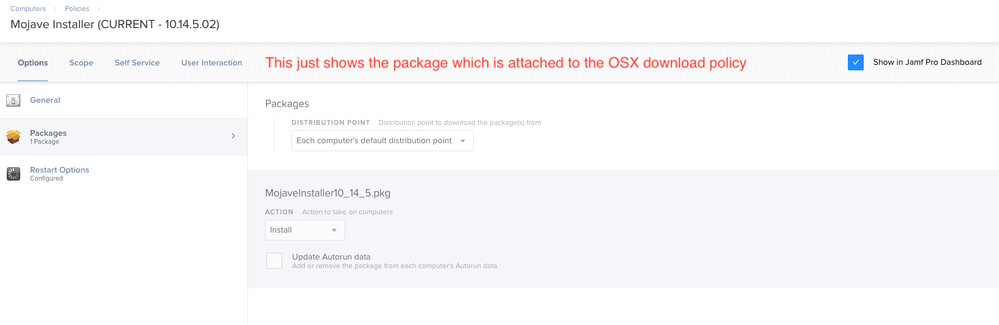

It does require the following policies and smart groups to be configured.

The version build number of the installer
Variable Name: versionBuildNumberOfInstaller
Location: as a parameter within the policy
Note: this is important so that the computer has the CURRENT OSX installer placed on the computer. If the build number of the installer on the machine does not match the one set in the parameter it will remove the existing installer and re-download the latest one.

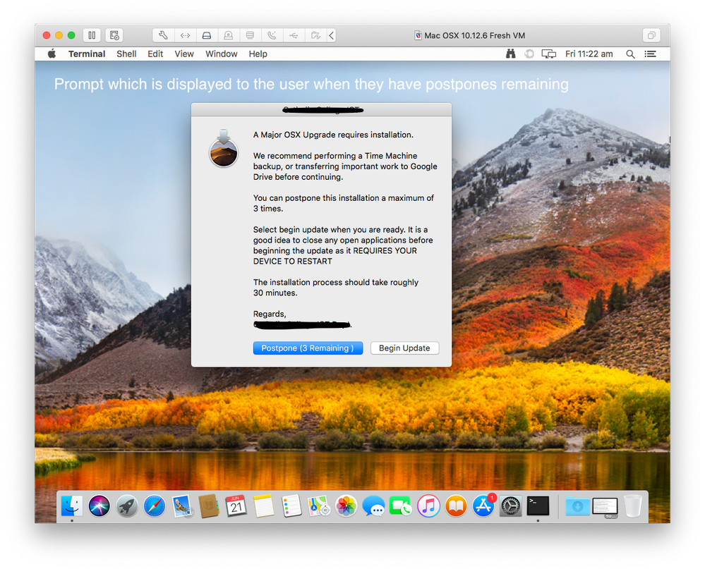

# This message is displayed to the end user in the Apple Dialog box. It appears when they have not reached their maximum number of postpones.
REMAININGPOSTPONEMESSAGE="A Major OSX Upgrade requires installation.
We recommend performing a Time Machine backup, or transferring important work to Google Drive before continuing.
You can postpone this installation a maximum of $MAXPOSTPONE times.
Select begin update when you are ready. It is a good idea to close any open applications before beginning the update as it REQUIRES YOUR DEVICE TO RESTART
The installation process should take roughly 30 minutes.
Regards,
<<Your business name>>."

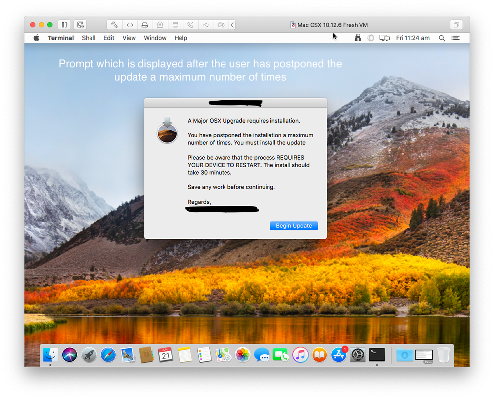

# This message will be displayed to the end user after they have postponed the installer the maximum number of times.
NOMOREPOSTPONEMESSAGE="A Major OSX Upgrade requires installation.
You have postponed the installation a maximum number of times. You must install the update
Please be aware that the process REQUIRES YOUR DEVICE TO RESTART. The install should take 30 minutes.
Save any work before continuing.
Regards,
<<You business name>>."

if [[ $postPoneRemaining -le 0 ]]; then
updateMessage=$NOMOREPOSTPONEMESSAGE
updateMessage=$REMAININGPOSTPONEMESSAGE

set dialogResult to display dialog "$updateMessage" buttons {$(if [ $postPoneRemaining -gt 0 ]; then echo ""Postpone (${postPoneRemaining} Remaining )","; fi) "Begin Update"} default button 1 with icon file InstallerPath with title "<<Your business name>>" giving up after $APPLEDIALOGTIMEOUT
if the button returned of the result is "Begin Update" then
set updateStatus to "Update"
else if gave up of dialogResult then
set updateStatus to "TimeOut"
set updateStatus to "PostPone"
end if

6. Here are some screenshots of what it should look like
