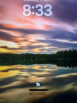

I have an issue in most of the mac, after enter the password it will stuck by showing loading like below image. This is happening for while restart and login or after un lock the device, to login need to do force restart the MacBooks. Does anyone faced this issue? Any solution for this?

I have seen this a lot when there are a lot of apps or agents loading at login or startup. Once you can get in, I would recommend looking in /Library/LaunchAgents, /Library/LaunchDaemons, and in /User/Library/LaunchAgents to check what may be loading when you startup and/or login to the Mac.

If you are tracking this to the time window where you deployed EPM, you need to have the team that owns EPM review their policies and logs. If they are blocking a process that is preventing logging in to the OS there is nothing you can do to fix it from the MDM side.
If you are able to, uninstall CyberArk and check if the issue goes away. If it does, then you have proof that it's negatively affecting your login process.
