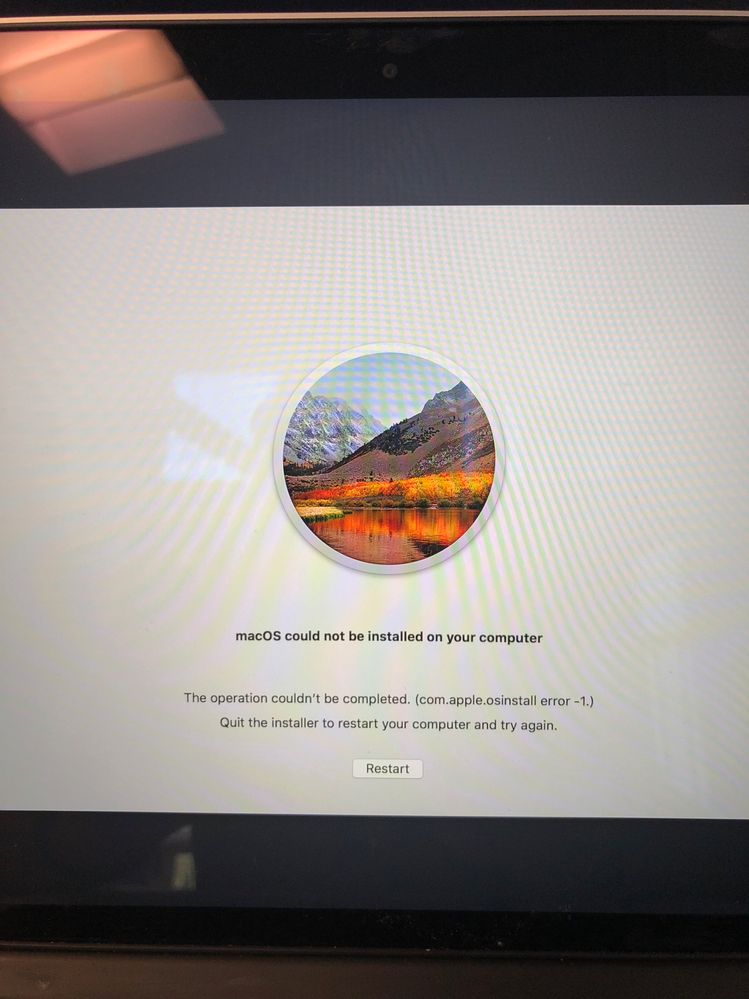

Any help on this would be much appreciated. We have two MacBooks which we've installed Jamf on. It appears that before being enrolled these two machines must have pulled down the 13.6 update but it was not installed by the user.
After the enrolment, Jamf rebooted the machine and began its update of the OS. But after the machine reboots, this message appears and after you reboot, its gets stuck in a loop. The only way to stop it is to go into the boot options and reselect the hard disk.

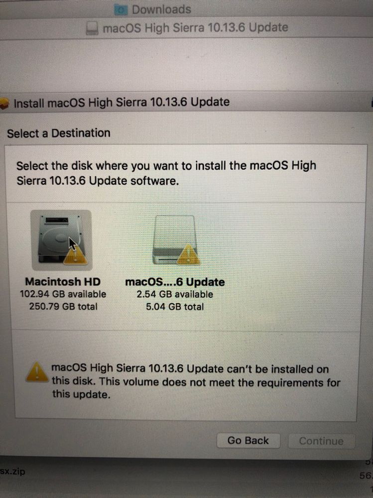

Now, if you go into the AppStore, the 13.6 update does not show up, so we downloaded the Combo Update for 13.6, but when you run the installer, you get the following message stopping us installing the update.

I saw this the other day too. We booted into Safe Mode ok, but still would loop when rebooting normally. ended up imaging the damn thing. Not that this helps you at all, but you are not alone.

Combo Updates don’t work. Use the full installer instead.
I read on a public forum that this is fixed in 10.14 Beta 4.

Already tried to bless the macintosh HD bootdisk with starting up with ALT and after that CNTRL on the selected disk till a looping icon appears and click it
