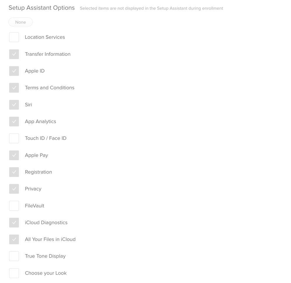

We are running into a weird issue. With our 10.13 and 10.14 machines, we are running into the issue where the following items are not shown to be configured during setup:
They are selected to not be skipped (some of the only ones we want the user to configure) but they are not shown at all.
Here's a screenshot:
We also tested just turning them all on, and it's still skipped, not sure what's going on. Anyone else running into this issue?

Posted on 10-29-2018 08:51 AM
These ones only show up when the user logs in for the first time, so not during initial set up.
Posted on 10-29-2018 09:50 AM
Thanks for the response! These are not showing once the user logs in - it goes directly to the desktop at the moment. Might have something to do with NoMAD Login+ JIT user creation.
Posted on 11-13-2018 05:19 AM
Update: This is working with no issue on machines that are enrolling with 10.14.1.
Not sure what the issue is, but we are only rolling forward with 10.14.1 or newer so all good here!
