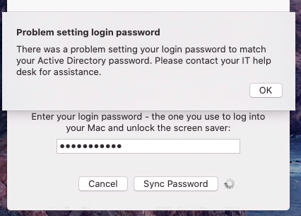

On a test Mac I converted my mobile account from mobile to local using Rich Trouton's script. This appears to have worked without issue. I've then applied a simple config profile to the test Mac to enable the Kerberos SSO Extension. I can sign in and get a solid key icon in the menu bar and all appears well. However, it realizes that the account password is different than what's defined in AD. I get prompted to put in the AD password and then the local password. It attempst to sync the local account password with the AD password but keeps failing - "Problem setting login password" "There was a problem setting your login password to match your Active Directory password." Please contact your IT help desk for assistance." I've tried this numerous times and it fails each time. dd62f6985c4f49a9a124bd98260f60d6

@stephanpeterson Do you have a password policy enforced on your Macs that's different than what your AD password policy is? I haven't tested it with the Kerberos SSO, but I do recall seeing this behavior with Enterprise Connect when a Mac had a password policy that required a number, but the AD password policy was configured for either number or symbol.

@sdagley I'm trying to track down if we have one that's hanging around in the background somewhere. I tested by enrolling a Catalina VM that's plain vanilla macOS and password sync works just fine. I tried pwpolicy -clearaccountpolicies and a restart but that didn't help. Must be lurking somewhere else...
@stephanpeterson What does pwpolicy getaccountpolicies show for your password requirements?
GregE
We found that the 'no sequential characters' setting was lingering around. Running systemextensionsctl reset sorted that out.
A way to test (if FileVault enabled) - unlock the drive using the Recovery Key, then at the Change Password field enter your new password. If you get a bunch of green dots and a single grey one - either a config profile or lingering setting in your Kerberos profile (it has a sequential characters option) is hanging around.
