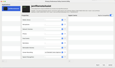

Posted on 01-06-2025 09:33 AM
Wonderingwhat others see compared these screenshots. When I manually toggle on the Privacy and Security > Screen Sharing & Audio System Recording setting for jamfRemoteAssist then I can get Jamf Remote Assist to work.
But the Jamf video setup instructions have a checkbox that is no longer anywhere that I can find to default these permissions to on.
Posted on 01-27-2025 01:33 PM
Yea, I'm having the same issue. Worked when I first tested it months ago. Now noticing several machines with the jamfRemoteAssist being off by default. When I manually enable, remote assist works. Didn't previously have to do that.
Posted on 01-28-2025 12:29 PM
Looked at this again today. Can also confirm that it works when enabling Screen & System Audio Recording for jamfRemoteAssist.
I tried to create a PPPC config for it, but it doesn't seem to work to enable it.
At least it looks like standard users can enable it, so it's possible to instruct a user to go into settings > Privacy & Security > Screen & System Audio Recording and enable for jamfRemoteAssist.
Interestingly, you can see the built-in Jamf PPPC for it (General > Device Management), with several things listed but it doesn't seem to work either.
Below is my own PPPC, the "Receive UI Events..." is input monitoring.

I copied his settings for Remote Assist access and it does not work. I deployed it out and failed to deploy.
Posted on 04-08-2025 05:39 AM
By deploy, do you mean that you were unable to connect to the target machine? previously in this thread you said that it started working for you.
Posted on 04-08-2025 05:45 AM
No. I modified my package to include the settings in your post and it failed to deploy. However, I was somehow able to remote into my mac afterwards but then it stopped working again. I do not have a working method for this and need to because I have people who are chomping at the bit to get this working.
Posted on 04-08-2025 05:56 AM
Config profile failed to deploy? The Remote Assist isn's a package to deploy.
I don't think the custom PPPC profile is actually necessary. I can't test whether removing it makes a difference at the moment, but I believe the defauly built-in one is already doing whatever it can. It just requires the user to manually enable permissions in screen sharing settings per Apple's user privacy initiatives.
Have you been instructing users to enable permissions for screen sharing? If they are able to enable screen sharing without admin prompts then the default PPPC is working.
For example, standard users are normally not allowed to allow screen sharing for Teams or Zoom, so I've recently had to build a PPPC to "Allow standard users to approve"; they still need to go into the settings and enable it, but no longer get a prompt for administrator credentials.
Posted on 04-08-2025 06:00 AM
does anyone have the code requirement for Jamf Remote assist?
