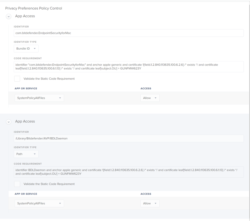

The PPPC utility is great. I believe it will spit out a config that you can upload to JSS as well.
I think your executable path may be wrong, here is one of our profiles.
