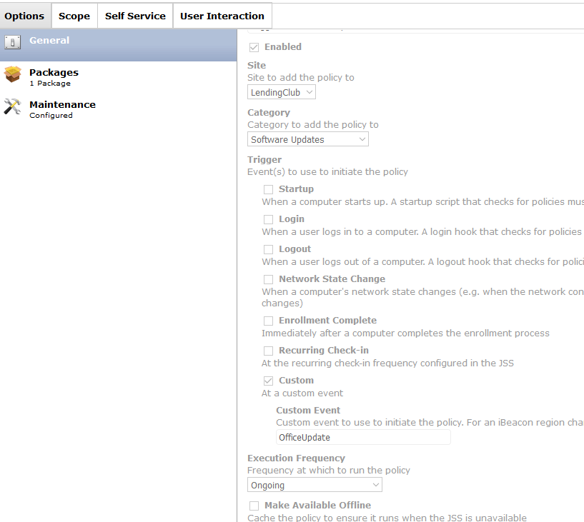

I've set a custom trigger with execution frequency as Ongoing.
On the first initial run, it'll work properly. If I try to run it again on the same machine, it'll say "no policies were found for the "xxxxxxx" trigger.
I've tried flushing the log and re-running to no avail.
If I edit the policy that contains the custom trigger, and save it exactly as is, it'll work when I re-run the policy.

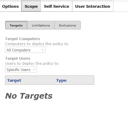

Did you figure this out? What is the scope on the policy?
bbot
Never figured it out. Will try testing again today.

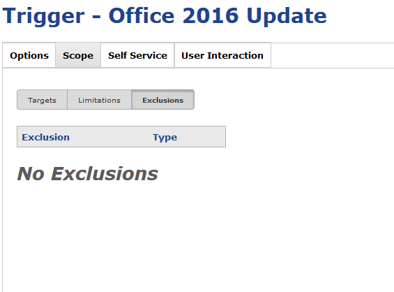

Scope on policy is All Computers with no exclusions. No server or client side limitations.63050c2ad27c4325a4776f521759a187

@kerouak Have you tried a Target of Specific Computers -> All Managed Clients rather than All Computers?
