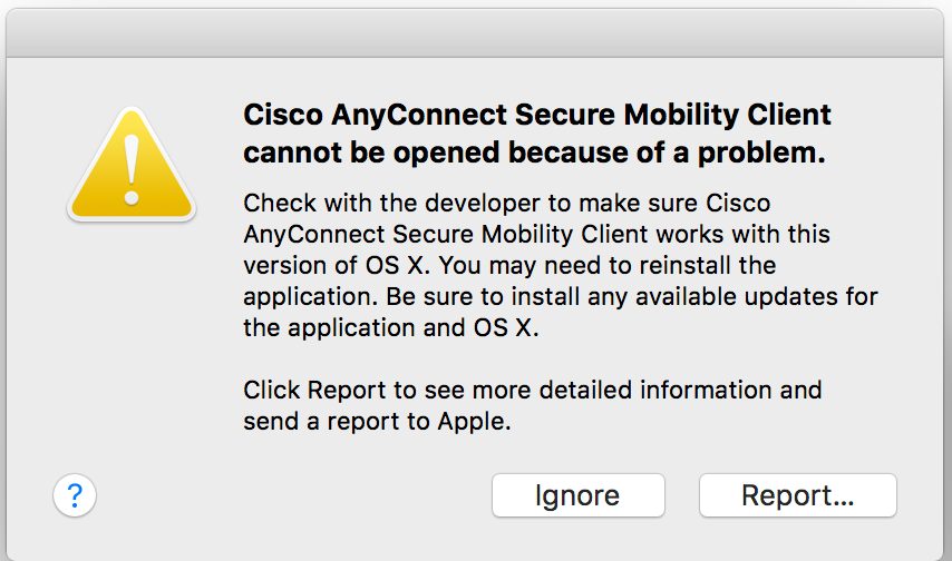

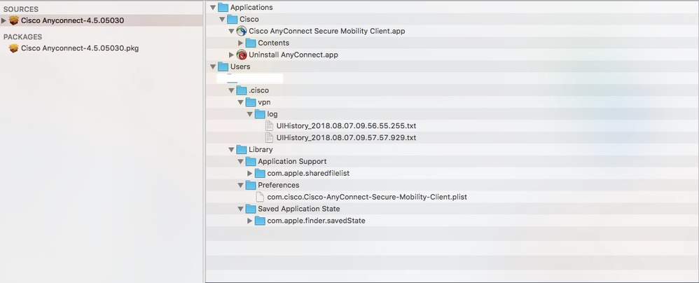

Hi, I'm using Composer to install the new VPN client, I go through the motions untick everything apart from VPN and then finish the installation and it launches with no issues, after I closed it and re-opened it on 4 different occassions.
We deployed VPN certificates which we tested and are working fine, on older versions and the 4.5 on the test machine.
So now the package is in Casper Admin, created a policy for it to be installed as a
Self Service method, it successfully installs the pkg but when launching the applications I keep getting different errors on various test machines.
Any ideas on this?

You shouldn't need to do a Composer capture for AnyConnect. It's likely messing up the deployment using it like that. See if you can get access to the full pkg installer. Ask whoever manages your VPN stuff or has access to Cisco AC installers to get you the Mac installer for core VPN.
This file name below is for the previous 4.4.x version, but the 4.5 one should be similar in nature. This installs just the core VPN components. This is what I'm using, along with the DART webdeploy installer.
anyconnect-macos-4.4.02039-core-vpn-webdeploy-k9.pkg
Hope that helps.

It appears the pkg that I got was corrupt as I got an ex colleague to test in his environment and got the same issue as me. So I managed to get v4.4.0.04030 and worked perfectly when running the pkgutil commands.
So I followed all steps as advised. for some odd reason I am still getting the issue below. To be on the safe side I copied a working XML server config from /opt/anyconnect/profile, created that into a PKG, so now my policy runs the anyconnect pkg and then the XML server config but I am still getting that message.
Any ideas where I could have gone worng
