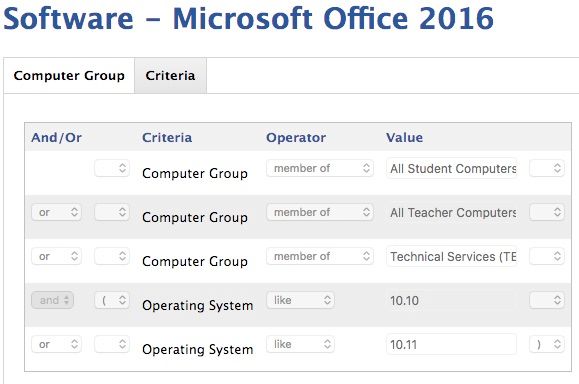

@alexjdale You can avoid reinstallation on re-enrollment by creating a Smart Group for machines with the software installed, and excluding that group from the Scope of your Policy that does the installation.
@millersc One of the things stressed at the Jamf trainings is that you don't want to over craft your Smart Groups as you incur overhead for each one. So for your Office 2016 Policy I'd use the 3 computer groups as the Scope Targets, and have a Smart Group with OS < 10.10 as an Exclusion.

@sdagley I've spoken with many TAMs about the overhead and it's impact. I believe it really falls on each environment and admin. I wouldn't have to even use Smart Groups if jamf would go back to using AD Groups like it used to in 8.x. This would off load a lot of the heavy lifting, while only need a few Smart Groups on the jamfPro server.
