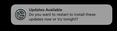

Posted on 02-01-2023 06:35 AM
I thought I disabled update notifications from Apple via config profile by unchecking "Allow software update notifications" in the Restrictions > Applications section, yet I still get these:
Did I miss something?
Thanks.
Posted on 02-01-2023 08:13 AM
@llitz123 Feel free to use mobile config from my GitHub Page https://github.com/Samstar777/Disable-Apple-Software-Update-Notification

Posted on 04-17-2025 12:54 AM
i can confirm it does still work on sequoia. i just added the bundleID ( _system_center_:com.apple.softwareupdatenotification ) and disabled both critical and notification in jamf config in notifications.
Posted on 02-01-2023 08:17 AM
I'll take a look.
Should I remove the settings I have in place when I add the mobile config?
Thanks.
Posted on 02-01-2023 08:21 AM
@llitz123 Yes, please do remove / modify your existing settings.
