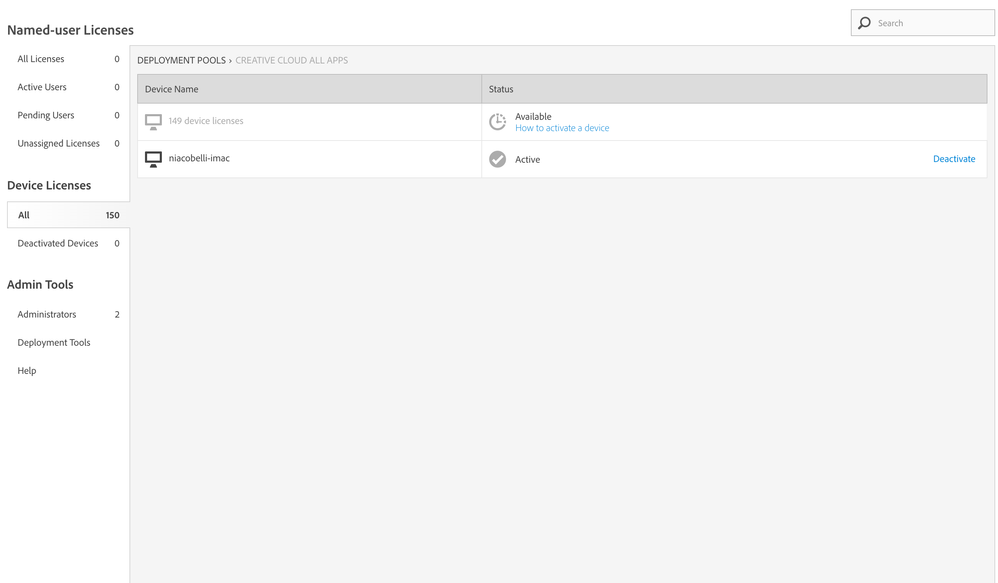

niacobelli
We are using the Education licenses and they get deployed by device. I can see all the activated devices for our organization. I'll take a look at those resources from Tim Sutton.
Just to rule out the creation of the files, I created the package in a fresh OS in VMWare and still had the same result.33894ef363d74551871d74cbe3a2fdd9
Nix4Life
@niacobelli I am also in K-12, and had to do this yesterday. I had to deactivate a license, I then used the license pkg to reactivate. It may take a few hours for the newly activated machine to show up in the console, but it will
