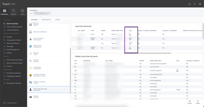

Inventory Record > General > Local User Accounts > Scroll to the right and look at "Size". That should give you a decent idea of how much data is being used for the user profile. Beyond that I probably would not use JAMF to attempt to identify disk usage. Any Commands that could gather this information will take a significant amount of time to process, and tie up all management while they are running.

A note for posterity - you may need to enable this, at least it was not on by default in my jamfcloud environment. To do so, go to Settings > Computer Management > Inventory Collection > tick Include home directory sizes.
Beware - enabling this will add time to inventory, esp. if you've got folks with many gigs of small files like developers pulling down an entire large software repo. :-p
