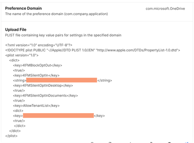

Hello,

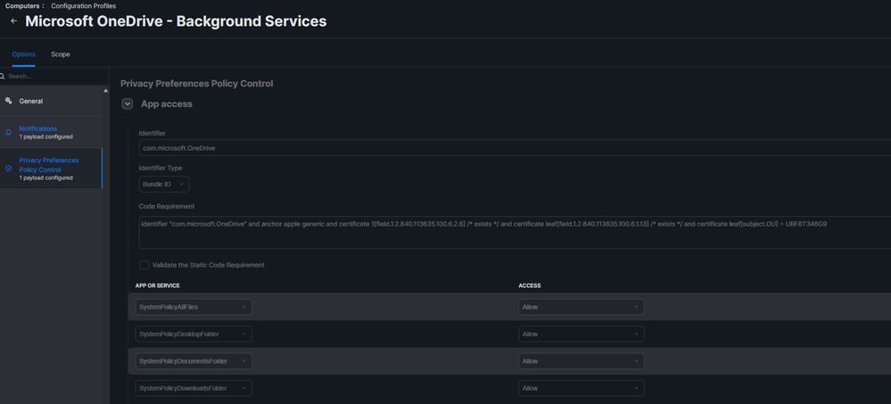

I still can't get mine to work. Do you also have a PPPC setting enabled? I couldn't find any instructions for it. Does mine look correct to you?
Tried it, and its still not working. Really not sure what I am doing incorrectly.

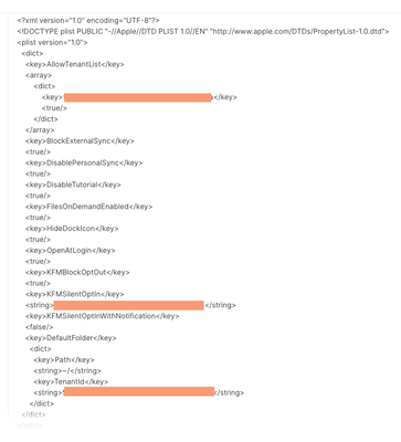

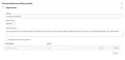

Are you able to supply what did eventually fix it for you? I have been dealing with the same issue as you. I think I have everything set properly with a PPPC and the plist but having no success getting KFM to actually work. I know parts of the plist is working though because if I manually enable Backup, I'm unable to stop it. I have tried basically everything I could think of except asking for help!
    <key>AllowTenantList</key>
    <array>
            <key>TENANT ID</key>
            <true/>
    </array>
    <key>BlockExternalSync</key>
    <true/>
    <key>DefaultFolder</key>
        <key>Path</key>
        <string>~/OneDrive - Company</string>
        <key>TenantId</key>
        <string>TENANT ID</string>
    <key>DisablePersonalSync</key>
    <true/>
    <key>DisableTutorial</key>
    <true/>
    <key>EnableSyncAdminReports</key>
    <integer>1</integer>
    <key>FilesOnDemandEnabled</key>
    <true/>
    <key>HideDockIcon</key>
    <false/>
    <key>KFMBlockOptOut</key>
    <true/>
    <key>KFMSilentOptIn</key>
    <key>KFMSilentOptInWithNotification</key>
    <true/>
    <key>OpenAtLogin</key>
    <true/>
