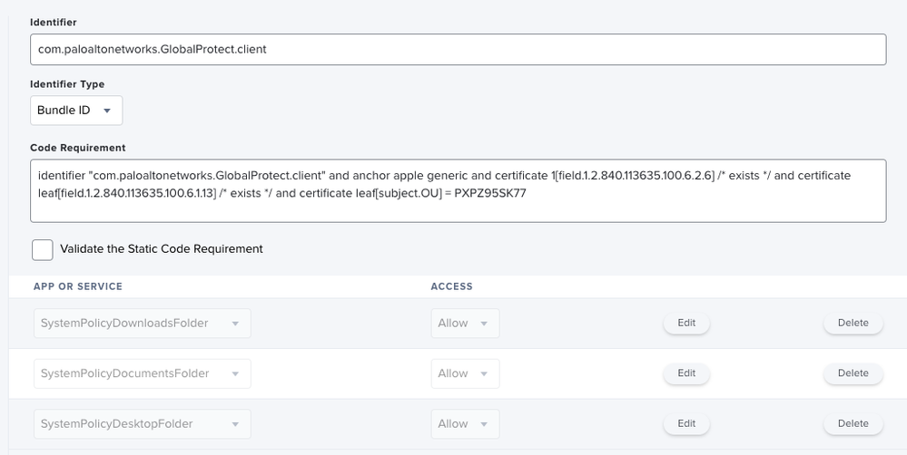

Hi All,
So we're moving to a newer version of Global Protect, 5.1.4 from 5.0.4, and have PPPC settings via Configuration Profile allowing access to the Download, Desktop, and Documents folders explicitly - just to reduce the number of click thru's required and potential calls from employees.
The changes in 5.1.4 seems to require an addition to the PPPC settings since apparently the bundle now has an additional '.client' at the end of it. I made the additions but something is still off and and the requests for access are still coming through.
a3cb3b40193d41ea98e9b3db709e7a3c
Wondering if anybody else has run into this also or has any ideas.
Thanks.

@tommersyip Looks right to me, but we're still deploying 5.0.x
What does the output of codesign -dr - /Applications/GlobalProtect.app look like?
tommersyip
Looks correct, right? Weird.
This is the output of codesign -dr - /Applications/GlobalProtect.app
Executable=/Applications/GlobalProtect.app/Contents/MacOS/GlobalProtect
designated => identifier "com.paloaltonetworks.GlobalProtect.client" and anchor apple generic and certificate 1[field.1.2.840.113635.100.6.2.6] /* exists */ and certificate leaf[field.1.2.840.113635.100.6.1.13] /* exists */ and certificate leaf[subject.OU] = PXPZ95SK77
I did use that to create the PPPC originally. Wouldn't shock me if PAN did something weird with GlobalProtect
