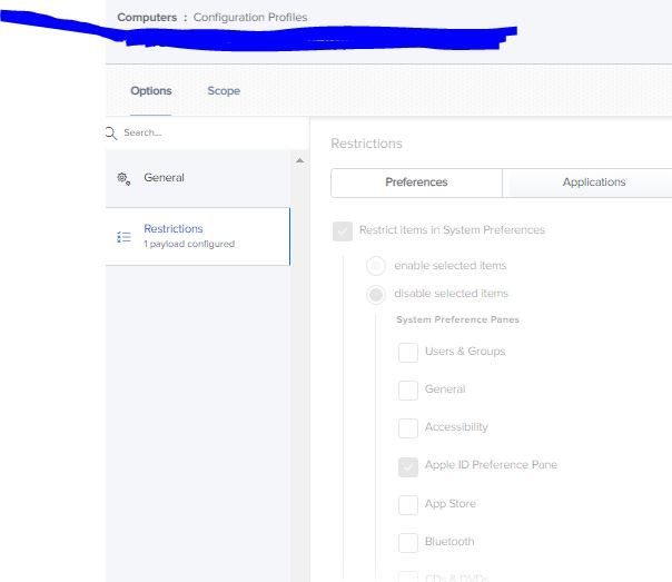

We tried disabling "Apple ID Preference Pane" from jamf using configuration profile.
But still looking for more option.
Thank you.
How do you did that ? Does it work ?
We tried this and it works,
