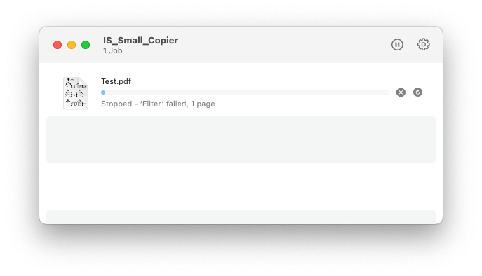

We are having a hard time printing PDF's this school year using Monterey on both Intel and Apple Silicon machines. Most are stopping in the print queue with a "Stopped - 'Filter' failed" error.
The only way we've found to get them to print most of the time is to do a Save As and then save as a JPEG. This is occurring with both direct print queues as well as print queues we share from a Windows Server using generic PostScript drivers. Most research (which doesn't show many recent discussions) shows to reinstall or update the drivers, which I've tried with our direct print queues, and also to try a right click>Reset Printing System and then reinstall printers, which I've also done with no change. Because this is happening with both manufacturer drivers as well as the Generic PostScript driver, I'm guessing it's a macOS issue? I did update one of my laptops from 12.4 to 12.5.1 in the process of troubleshooting and found it removed all of my print queues and I had to reinstall them all. At first I thought maybe this was an indication that Apple fixed something in the update, but not so, the issue is still present. The only other work around besides saving as a JPEG I've found is to print from Adobe Acrobat, which also points to a macOS issue possibly? I've found in Console that process cgpdftops is crashing each time I send a print job that stops:
