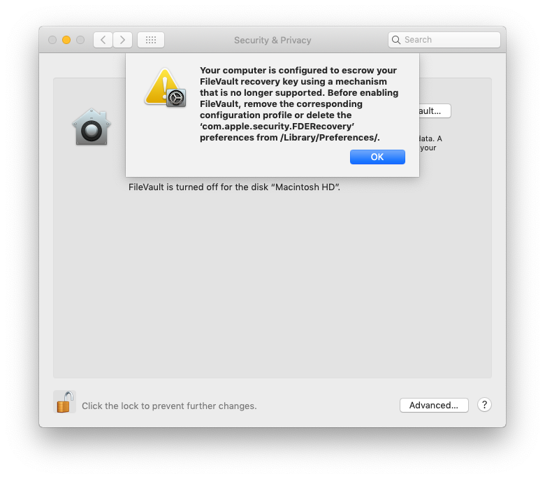

i'm using an established policy with JAMF PRO 10.7.1.
i just imaged this Mac mini MOJAVE 10.14 all config and policy are applying excepted FILEVAULT2 using an individual Key stored by JAMF
Did anyone encounter that error?

i also Got error Unknown 76 on the policy failed .

Do you have any configuration profiles installed on that Mac with the top level "FileVault Recovery Key Redirection" payload enabled? That won't work on anything past 10.12.
Can you do a defaults read on the com.apple.FDERecovery plist?

yes i do have a FileVault Recovery Key Redirection" payload enabled and yes its redirecting the key to my MDM.

You need to scope your redirection profile for 10.12 and older and create a new profile to escrow the key in 10.13 and higher. The 10.13 and higher function is located Under Security & Privacy ¬ FileVault using Jamf's built in profiles.
