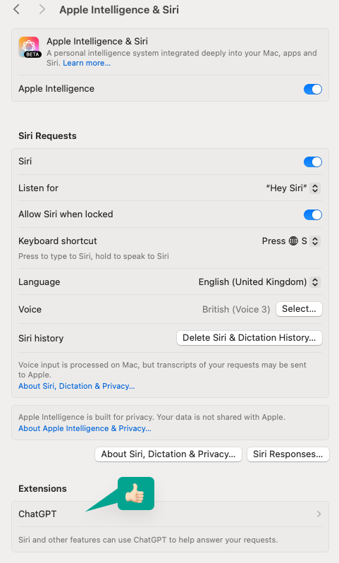

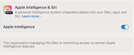

Hey folks,
I'm having trouble allowing users to use ChatGPT. We allow Apple Intelligence on all machines, and so have all the allow buttons ticked in the Restrictions profile, aside from 'Allow integration with external intelligence services (macOS 15.2 or later, supervised)'.
I've removed a few test machines from the scope of the standard config profile, and duplicated the Restrictions Config profile, and then only included a few test machines, and this time allowed integration with external intelligence services (macOS 15.2 or later, supervised). The initial ChatGPT entry is fine:SCR-20250507-ngse.png
but I'm seeing a strange blue box that almost looks like you could press it.

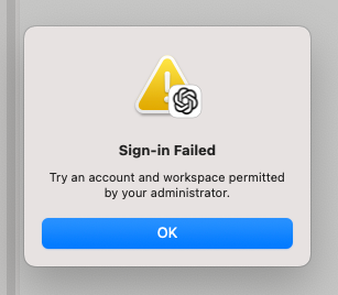

If you try to Use ChatGPT with an account, it doesn't allow that too (last screen shot).SCR-20250507-nhiz.png
Has anybody else experienced this?

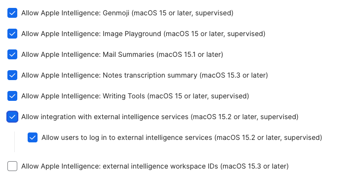

If I remember correctly, there have been issues reported when setting these features to 'Allow'. What happens if you remove the MDM profile for Apple Intelligence completely?
Greg1

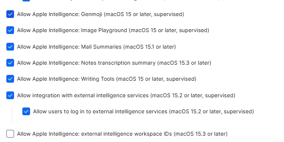

Here are my most recent steps.

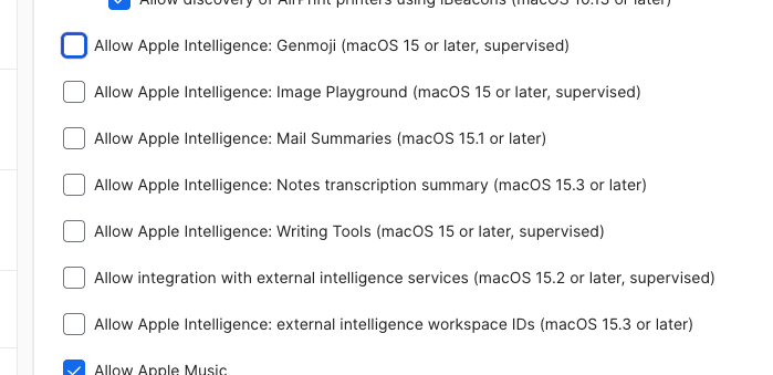

If I remove all tickboxes relating to Apple Intelligence
Save, and Distribute to all, my Dock reboots (a sign the machine has downloaded the changes), and I am still signed in to Apple Intelligence.
After a reboot, I am still signed in to AI, and ChatGPT is disabled. After a sudo jamf recon, AI is still signed in. Checking the profile, the tags are set to False:
If I manually turn off AI, I can just manually turn it back on.
If I head back to jamf, and turn back on most the AI stuff:
my Dock reboots, the ChatGPT option is then clickable at the bottom of the AI panel, but again, same blued-out box, and I cannot turn on ChatGPT

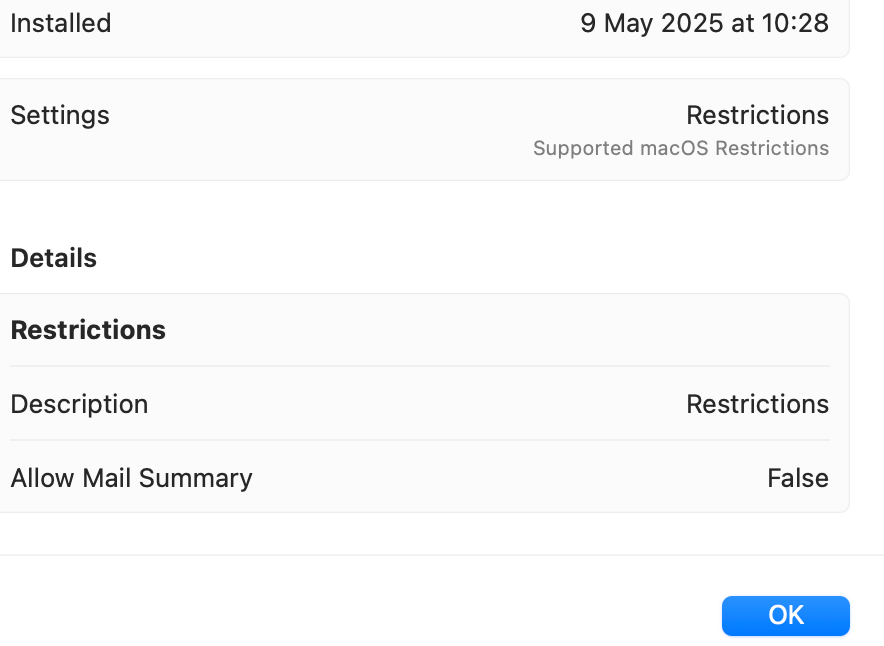

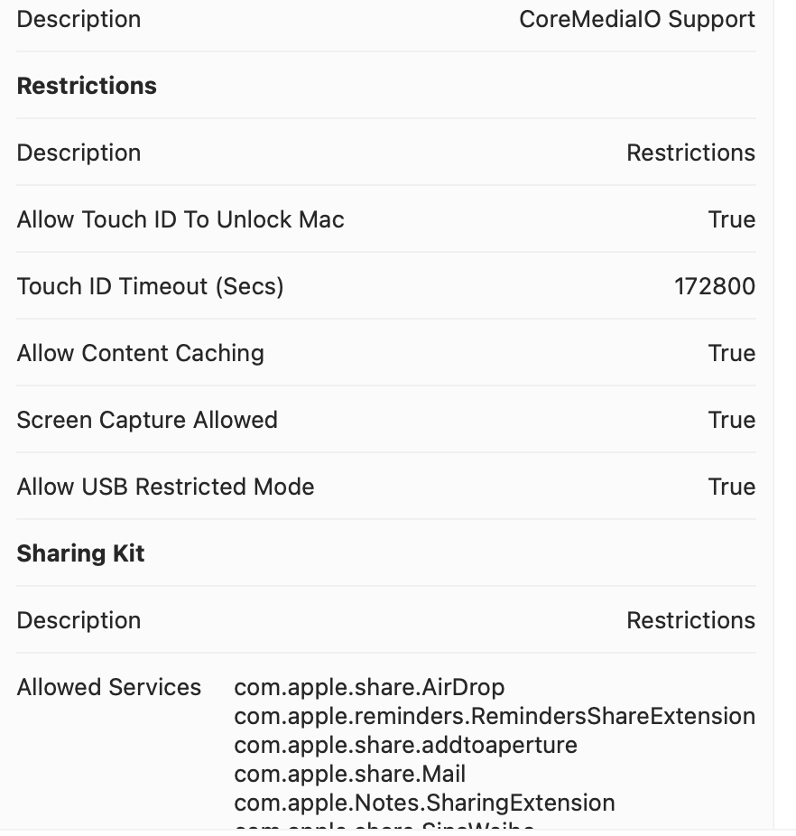

ceeghb
Interestingly when checking what's been pushed I don't even see the AI settings when they're enabled, perhaps this is normal, as when I DO restrict them I then see this reflected in settings;
Not sure if that's normal i.e. only disabled/disallowed settings get pushed?

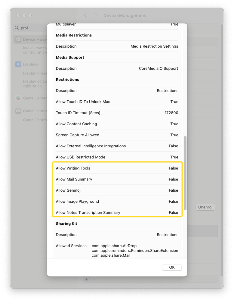

ceeghb
so done some testing with imazing, updated the Manifest Repository Update successfully and could see AI under 'other' tab.
Behaves like config profile pushed via Jamf, if allowed no settings are pushed but restrict something and it appears, but still doesn't fix my problem :(
