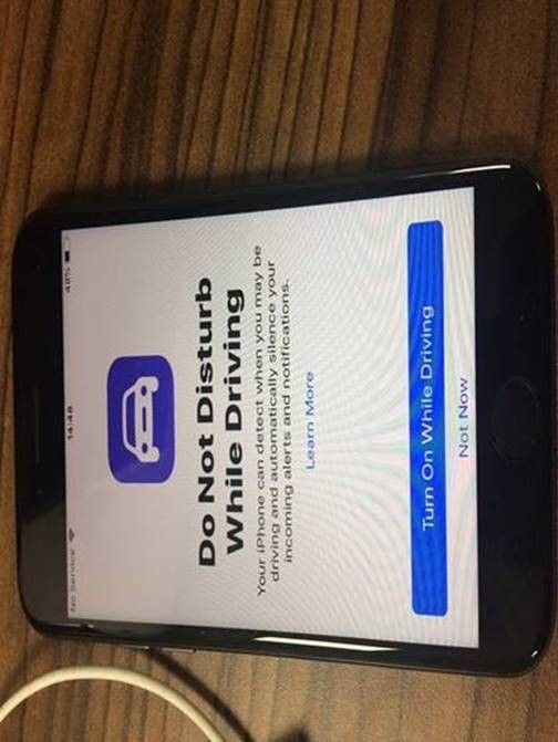

Hi , Clinical app devices are Going into CarPlay Mode when the user has been walking around with the device. Would you able to advise me how to disable CarPlay Mode in Jamf Configuration Profiles--Restrictions.

Hi all please see the screenshot

And the winner goes to @kevinwilemon . Either DNDWD is very sensitive or you have some really fast walkers.
I could be wrong, but the image in the top post appears to be a pane that appears during setup assistant.
DNDWD, when it kicks in, is just a simple notification on the lock screen that reads "DO NOT DISTURB WHILE DRIVING - You will not receive notifications while you are driving." You can tap on that notification to bring up a button that says "I'm Not Driving."
I'm not yet current on my JSS, but on mine, I don't see an option to skip a DNDWD pane in a prestage, unless it's grouped under "new feature highlights." You could try that - create a prestage for the device, tell it to skip "new feature highlights," and reset the device to see if that DNDWD pane goes away.
