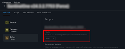

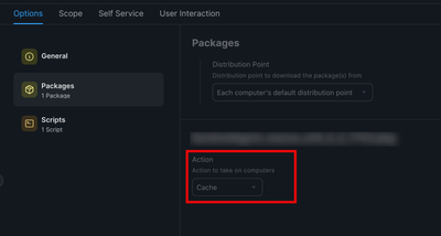

Sent1 is an odd bird, you need to cache the package, not install the package and the script need to run after the package has cached. Make sure the package is set to cache, and the script is set to run after.
You did not share your script, but just incase it should look like this.
sudo echo "$4" > /Library/Application\ Support/JAMF/Waiting\ Room/com.sentinelone.registration-token
sudo /usr/sbin/installer -pkg "/Library/Application Support/JAMF/Waiting Room/$5" -target /

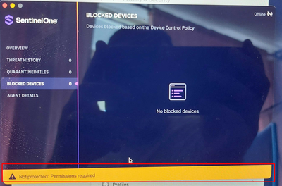

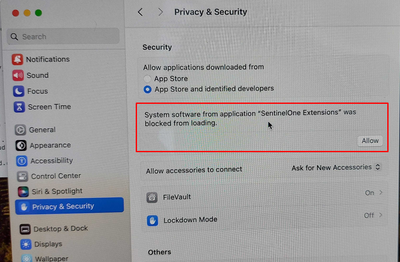

but now I have issue with application permission after the S1 installed
Just to know

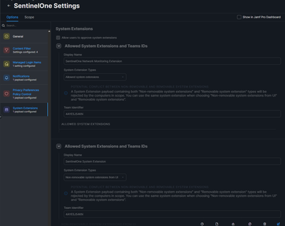

I have make this before
Looks like you left off the Allowed System Extension, com.sentinelone.network-monitoring should be added.
Another suggestion, break up the Configuration Profiles. Unrelated payloads should be in their own Configuration Profiles. For example the certificate for an 802.1x network would be related and need to go in the same Configuration Profile. However, a Packet Filleter and PPPC Configuration are not related and should be separated. This allows you to troubleshoot one at a time without messing with the other. All of this may be for Sentinel One, but a single Configuration Profile with a ton of payloads can be a beast to troubleshoot.
Just to know

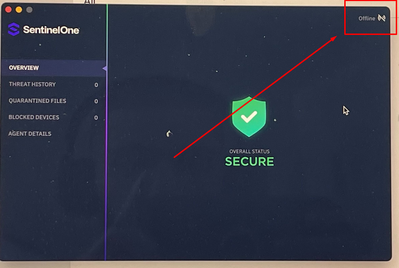

Hello @AJPinto
after we installed the SentinalOne the Application status is Offline do you know why and how we can fix it?
Thanks for help again.
