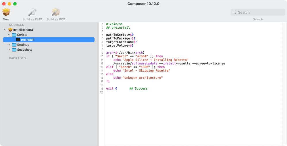

@txhaflaire how would you package the scrip on prestage? So this will ignore intel machines and only install on m1. looks good
!/bin/bash
arch=$(/usr/bin/arch)
if [ "$arch" == "arm64" ]; then echo "Apple Silicon - Installing Rosetta" /usr/sbin/softwareupdate --install-rosetta --agree-to-license
elif [ "$arch" == "i386" ]; then echo "Intel - Skipping Rosetta"
else echo "Unknown Architecture"
dmiguel

ThijsX
@dmiguel Just set it as a postinstall script when creating your package and that simply it is.

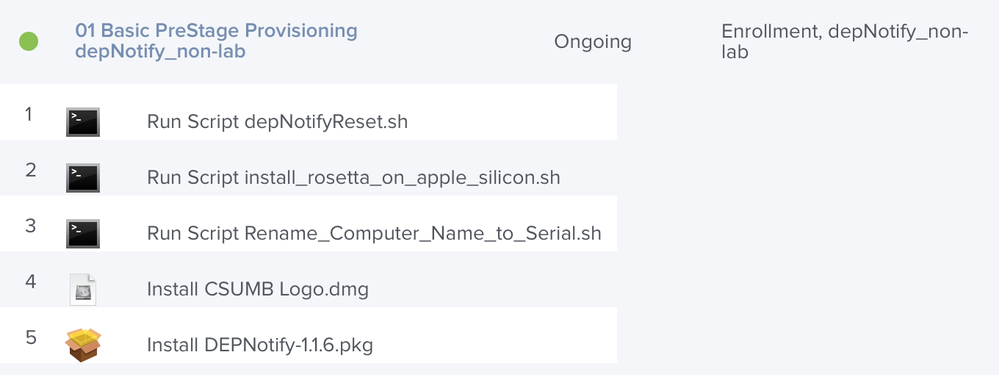

michael_madsen
@walt I use an enrollment policy which contains:
- Package (DEPNotify 1.1.6)
- Script (the script to make DEPNotify do it's thing)
However DEPNotify.app is not even downloaded to the machine if it's an M1 and Rosetta isn't installed.
I don't want to have to name my policies 0something or *something to make them run before other policies - of course this is a hack.
I want Rosetta to be installed in pre-staging
walt
@michael.madsen definitely file feedback with Apple as it should be installed natively with Big Sur at this point. You could also create a feature request with Jamf that perhaps Jamf deploys/checks for rosetta during DEP/ADE/other user enrollment.
I don't agree with the mentioned method being a hack, I mean look at Jamf in the big picture, everyone does things differently with their Jamf environment as its really choose your own adventure, I know there are feature requests to prioritize policies and other methods..so its definitely a method to accomplish what you want to do.
My suggestion is to simply create a new script with the above rtrouton script and add that to your DEPNotify policy as a Before script and it will run before the package is installed and should take care of the issue you are facing. since it's running purely as a script rather than a package (and similar to the separate policy that was recommended earlier, but my use case is its in a single policy).

michael_madsen
@walt Thank you, this (Add script to policy as "Before") actually worked.

MacGeek
David, I think I'm doing the same thing as you but I can't get it to work. I have a smart group already created that will detect the M1 chip. In Composer I made a new install package that only has a preinstall script listed below. When I run the policy it shows that it installed but when I check the Mac it didn't. If I just run the the preinstall script locally it works.
I know I could just set this all up in the Policy itself but I need to have an installer package for our users that aren't in Jamf. What are your thoughts?
## preinstall
exit 0 ## Success
exit 1 ## Failure
