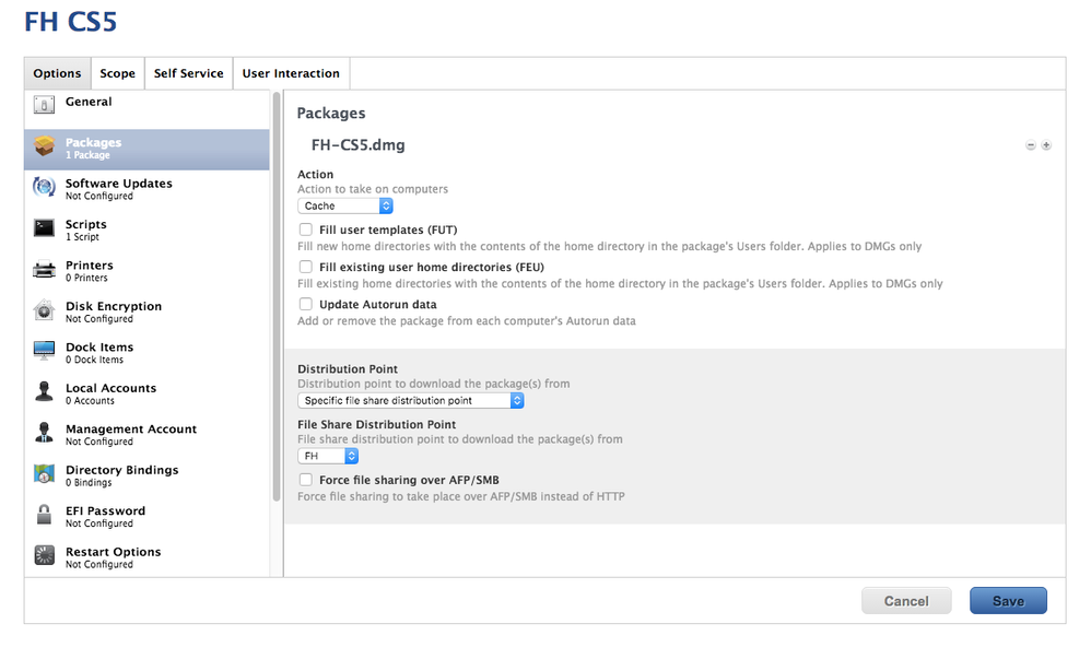

I took my AAMEE created pkg and wrapped it in a DMG using disk utility with no issues. I then uploaded it along with the installPKGfromDMG.sh script. I set the package to cache and set the script to run after the specific filename of the dmg. I then scoped it out and got this back on all the systems:

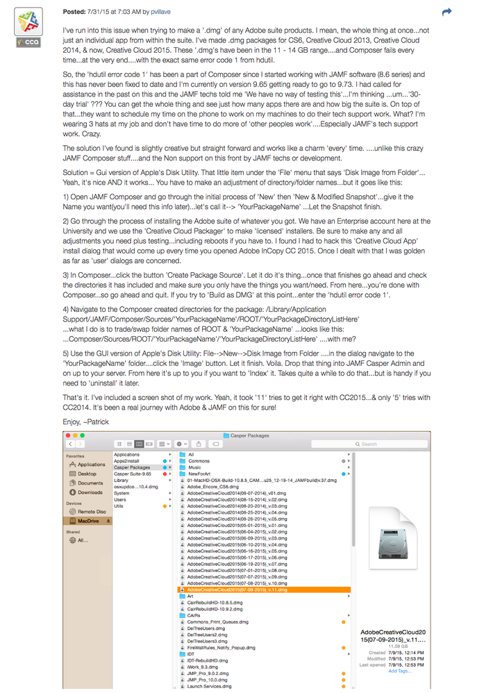

Figured it out eventually. I had to take my AAMEE created PKG, install it on a clean computer and take a snapshot via Composer. I then ran into a hdutil error because apparently Composer can't export DMGs that large. So I had to follow these steps:
After that I was able to add the DMG via Casper Admin and compile it in a config.

I'm pretty sure that I have it configured correctly to cache the dmg:
