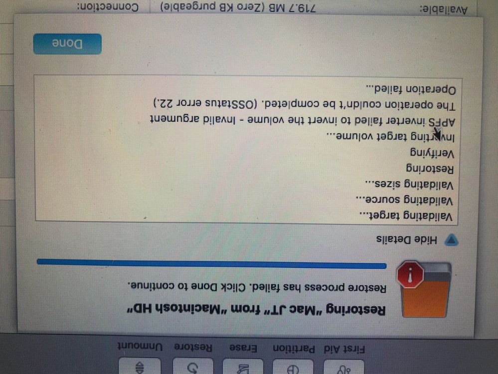

However, the problem I'm having is restoring the image created, either on the same machine that I created the image or on another Mac. Note: Both Mac disks are already formatted to AFPS and running High Sierra.
When I enter the below commands, I get an error stating "APFS inverter failed to invert the volume -invalid argument."
asr restore --source /Volumes/ExternalHDD/FinalImage.dmg --target /Volumes/Macintosh HD/ --erase

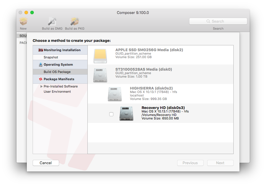

Hi @Chris_Hafner trying to follow your instructions. We were asked to start building Mac Book Pro and Mac Book Air High Sierra images and we're having a gang of trouble! When we get to the screen to select the disk in Composer, it's grayed out. Any ideas?
baf6e0b0b8ab481991feddba25f34aee
Chris_Hafner
Are you using FV2? Composer usually looks like that when dealing with an encrypted drive. That said, I have to get back around to testing this since I did shift away from using Composer for this over the past few years.
monaronyc
Thanks @Chris_Hafner! No unfortunately. This Mac Book Air hasn't been FV'd yet. I'm wondering if its the version of Casper we're on. 9.1.00.
msmith80
To capture the image you have to be booted into another device I believe. Target disk mode the device you want to capture and open composer on the second Mac.
monaronyc
Thanks @msmith80! Yes, that's what that screenshot i attached is. The firewire looking disk is at the top is mounted on the desktop of the computer where the Composer app is launched from.
