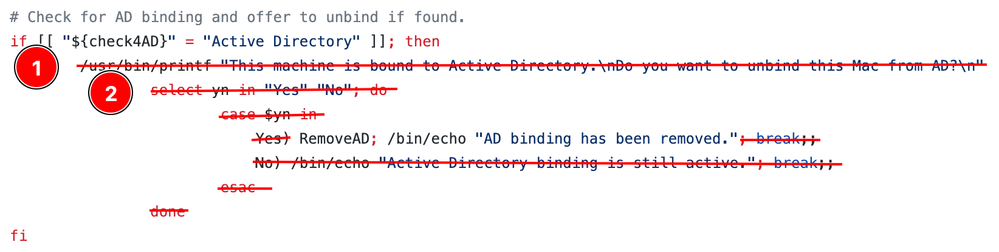

At the school where I work we are planning to convert the mobile user accounts (connected to AD) to local user accounts, and make them admins.
I saw the fantastic script on rtrouton's GitHub.
I tested it on a test machine and works like a charm, though the issue I have is that it asks for user input, and trying to push it via policy in Jamf, it simply waits.
So the question is: is there a way for me to achieve this via Jamf Pro, without the use of Jamf Connect (we currently don't have it)?
Thank you

I actually figured it out, confirming also what @MehdiYawari: I removed the user inputs ("select" menus) and now it works perfectly also from Jamf!

As long as you have credentials for both accounts, it should be possible. I would start here with Rich's write up
Posted on 05-05-2022 04:54 AM
Thank you, though it's not exactly what I'm looking for.
When I test the script on a test machine, the scripts needs user input in order to run. If I run the script via Jamf (with a policy), I can't see any of the user input, hence the script doesn't run, it just waits.
Maybe I'm missing some detail?
Posted on 05-05-2022 09:53 AM
Since scripts run as Administrator when run from Jamf, you can't get user input via terminal. You would have to rework the script to prompt the user via another tool (such as AppleScript or, maybe, SwiftDialog).

Im looking to do this for our exiting users through policy run script, by removing the input menus from the script will this just apply to the account running the script or all the mobile users it finds?
Posted on 11-27-2023 05:48 PM
@HariSeldon
can you share your version to skip the select options? I'm having trouble doing that, and I don't see why.
Posted on 11-28-2023 06:24 AM
Hey Malcolm,
What I did that worked for my case was to:
11-28-2023 03:52 PM - edited 11-28-2023 03:54 PM
Thanks, I ended up re-engineering script, it will process all mobile accounts and also then repeat and process all accounts as admin accounts for local accounts.

In the original, it seemingly does follow up checks which seem unnecessary for the task at hand. The netuser seems unnecessary as it had already determined that the user was an Active Directory one when extracting the users.
I might need to check mine above, as I want to remove the Active Directory status as the very last step, so to confirm all previous steps have completed.
I also want to see if there's a section to check if an account is disabled, as demobilising an account while it is disabled, is not going to have a very good outcome I suspect.

actually the script above is not quite right, so I will try your changes and see how I go
looked like it was working but the end user couldn't change their password.
Posted on 11-29-2023 02:04 AM
I could find the my updated version of the script, here you go:

# Stripped the script of all the user inputs (Select menu) and prompts to user
# in order to facilitate an automatic execution via Jamf.
# The main Select menu where the user account is being converted from Mobile to Local,
# has been changed into a for loop, also facilitating automatic execution.

# Check for AD binding and offer to unbind if found.
if [[ "${check4AD}" = "Active Directory" ]]; then
# Removed the Select menu, requesting user input in order to remove AD binding. Left only the command to remove the AD binding
RemoveAD; /bin/echo "AD binding has been removed.";

# Removed the two user inputs: 1) prompting the end-user to confirm whether the
# local account should be given admin rights, and 2) the Select menu
# to choose either yes or no. Left simply the command, that way
# it gets executed automatically, without the need of user input.
/usr/sbin/dseditgroup -o edit -a "$netname" -t user admin; /bin/echo "Admin rights given to this account";
for netname in $listUsers; do
# Changed the Select menu into a for loop, leaving all the commands inside unchanged.
# That way they get executed automatically without the need of user input
