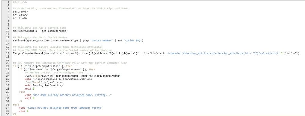

Posted on 03-05-2018 08:44 AM
Here You Go
## Grab The URL, Username and Password Values From the JAMF Script Variables
apiUser=$4
apiPass=$5
apiURL=$6
# Outputs a blank line for reporting purposes
echo
## This gets the Mac's current name
macName=$(scutil --get ComputerName)
# Outputs Current Computer Name
echo Current Computer Name = $macName
echo
## This gets the Mac's Serial Number
serial=$(system_profiler SPHardwareDataType | grep "Serial Number" | awk '{print $4}')
# Outputs Computers Serial Number
echo Computer Serial Number = $serial
echo
## This gets the Target Computer Name (Extension Attribute)
## From The JAMF Object Matching the Serial Number of the Machine
TargetComputerName=$(/usr/bin/curl -s -u ${apiUser}:${apiPass} "${apiURL}${serial}" | /usr/bin/xpath '/computer/extension_attributes/extension_attribute[id = "3"]/value/text()' 2>/dev/null)
# Outputs Target Computer Name
echo Target Computer Name = $TargetComputerName
echo
## Now compare the Extension Attribute value with the current computer name
if [ ! -z "$TargetComputerName" ]; then
if [[ "$macName" != "$TargetComputerName" ]]; then
## Rename the Mac to the assigned name
/usr/local/bin/jamf setComputerName -name "$TargetComputerName"
echo
echo Renaming Machine to $TargetComputerName
echo
sleep 10s
echo Forcing Re-Inventory
echo
/usr/local/bin/jamf recon
echo MATCH > /var/JAMF/Name+TargetName-Match.txt
echo "Mac name already matches assigned name. Writing Marker File"
echo "/var/JAMF/Name+TargetName-Match.txt"
echo
echo
echo
echo "Could not get assigned name from computer record"
