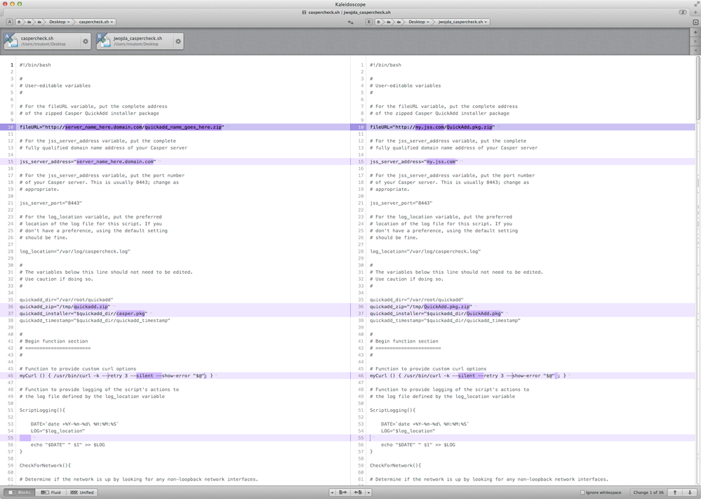

Would you please post sanitized copies of both the script and LaunchDaemon you're using? That may help folks assess what's going on, and why it's not working when run via the LaunchDaemon.
Posted on 08-04-2015 06:42 AM
@rtrouton Good call

Posted on 08-04-2015 07:21 AM
OK, after diffing your script against a stock copy of CasperCheck, I can point out a few places where you may be having issues:
The variables in this section have been edited and that's likely where your problems began.:
From:
# The variables below this line should not need to be edited.
# Use caution if doing so.
quickadd_dir="/var/root/quickadd"
quickadd_zip="/tmp/quickadd.zip"
quickadd_installer="$quickadd_dir/casper.pkg"
quickadd_timestamp="$quickadd_dir/quickadd_timestamp"
To:
quickadd_zip="/tmp/QuickAdd.pkg.zip"
quickadd_installer="$quickadd_dir/QuickAdd.pkg"
It also appears the myCurl function in the script has also been edited. CasperCheck uses this function to download the QuickAdd package from the address referenced in the fileURL variable.
It also looks like the myCurl function in the script has also stopped being used to download the QuickAdd (possibly because the edits to the myCurl function made it no longer work properly.) Instead the update_quickadd function has been edited to call curl without using the myCurl function.
However, because the directory path to curl is not being provided as part of the edits, the script is now implicitly relying on a PATH environment variable being available in order to find curl. That PATH environment variable is available when run manually using a logged-in user's account, so curl can be located when the script is run that way, but it isn't there when the script is run via the LaunchDaemon, so curl can't be found.
It may be worth starting over with a fresh copy of CasperCheck and not edit anything in the section marked below, or in any of the functions:
