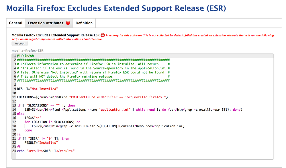

Firefox ESR - listed as being 47.0.1
Mozilla Firefox 45.3.0 ESR was released today on August 2nd:
https://www.mozilla.org/en-US/firefox/45.3.0/releasenotes/
Firefox ESR description - listed as Mozilla Firefox: Excludes Extended Support Release (ESR)
If I hadn't checked the EA for this Patch Reporting Software Title, I would have thought this meant that it was a confusingly duplicate listing for Mozilla Firefox's regular release. When I checked the included EA though, the script comments in the EA indicated it was looking for the ESR version.

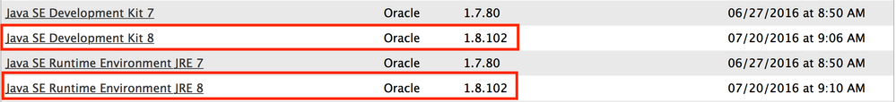

Java SE Development Kit 8 - listed as being 1.8.102
Java SE Runtime Environment JRE 8 - listed as being 1.8.102
Oracle has been releasing two separate versions of Java 8 simultaneously, one of which is the CPU release and the other is the PSU release.The difference between CPU and PSU releases is as follows:
Critical Patch Update (CPU): contains both fixes to security vulnerabilities and critical bug fixes.
Patch Set Update (PSU): contains all the fixes in the corresponding CPU, plus additional fixes to non-critical problems.
As of August 2nd, 2016, these are the two released versions:
CPU: 1.8.101
PSU: 1.8.102
Why this is important is that Oracle recommends most folks update to the CPU release and only install the PSU release if they are specifically impacted by one of the bugs in the PSU version's release notes.
For more details on the differences between CPU and PSU updates, please see the link below:
http://www.oracle.com/technetwork/java/javase/cpu-psu-explained-2331472.html

So it looks like the EA just flags up whether Firefox ESR is installed. Is that then used as a form of scoping?
Posted on 08-03-2016 07:07 AM
@rtrouton Thanks for comments about reporting. The FIrefox version 48 was recognized yesterday and is in the testing phases before we release that update. The ESR one is a little bit confusing, it was designed to ONLY update Firefox, not Firefox and Firefox ESR. The use case for the FIrefox Excludes ESR Software Definition would be an environment that has ESR installed and does not which to switch/update them to Firefox, thus only reporting on FIrefox.
As for the JAVA 8 CPU and PSU I will look into that this morning and see what we can do to match those reports with our reporting. I will post back once I have a solution. Also we will look into "adjusting" the FIrefox and FIrefox ESR definition to make more sense long term. Please keep the advice coming, so when Patch Management comes out we ready for anything!
