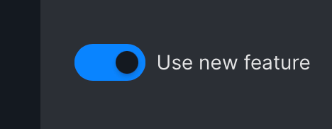

We go to the Software Updates tab and turn off the feature. Wait a bit. Then cycle it back on. Send DDM again.
Shyamsundar
Turning the OFF the software update feature will cancel the existing DDM
Chris_Cover
it will also cancel every other plan running AND remove all history.
