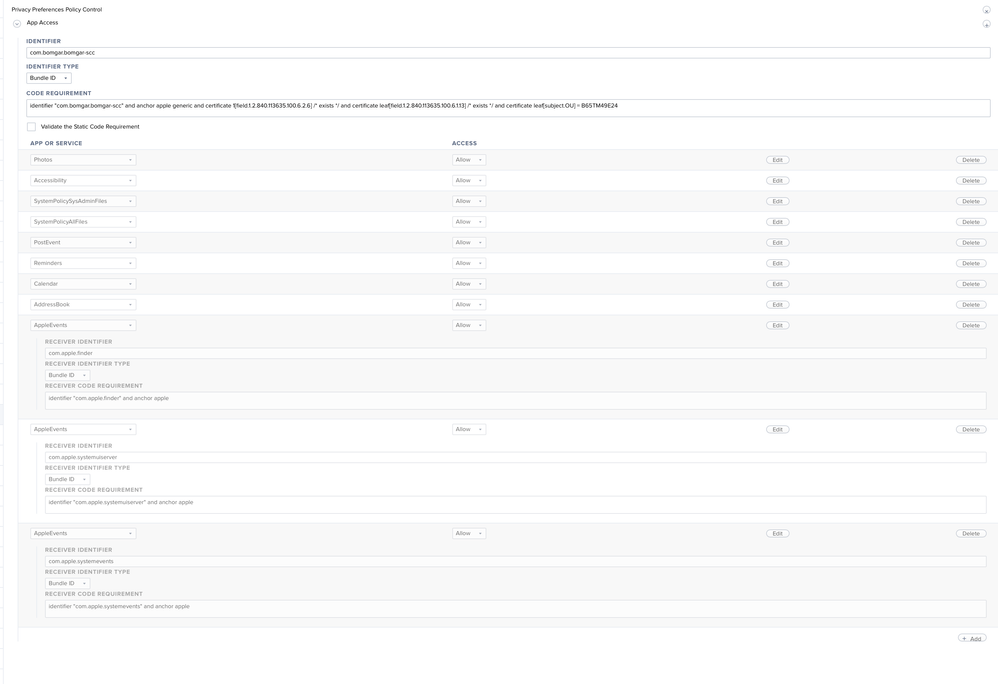

We started using Bomgar for remote support recently due to staff working from home. I am stuck in trying to push out a configuration profile that works to allow Accessibility so support staff can control the requestors Mac. What application am I adding into the PPPC to allow Accessibility? I tried Representative Console, which the support staff run locally to connect a remote session to the requestors, but that didn't work. I also tried the Support Session, which is the app the requestor downloads to initiate a remote session and that didn't work either. When I tried both, the requestor is still asked to go to System Prefs > S & P to allow. None of our staff have admin rights, so I am stuck here. Any help would be appreciated.
macm1
Hi @JeyT,
You will want to add the bomgar-scc binary in the PPPC utilty. Feel free to ping me on macAdmins slack (@macm) if you have any questions.
-R
JeyT
@rqomsiua
Hi, and thank you for responding. I did some digging myself and figure it out as it seems to be working on my test macs.
identifier: com.bomgar.bomgar-scc
Code Requirement: identifier "com.bomgar.bomgar-scc" and anchor apple generic and certificate 1[field.1.2.840.113635.100.6.2.6] / exists / and certificate leaf[field.1.2.840.113635.100.6.1.13] / exists / and certificate leaf[subject.OU] = B65TM49E24
I am scoping this out to my smart group, "JAMF PPPC Profile Installed" based on my JAMF cloud Security Settings "Automatically install a Privacy Preferences Policy Control profile on user approved MDM computers that grants necessary permissions for the Jamf management framework ( (macOS 10.14 or later)". I think I'm on the right track. Still trying to wrap my head around the constant configuration profiles needed by all my Mac apps.

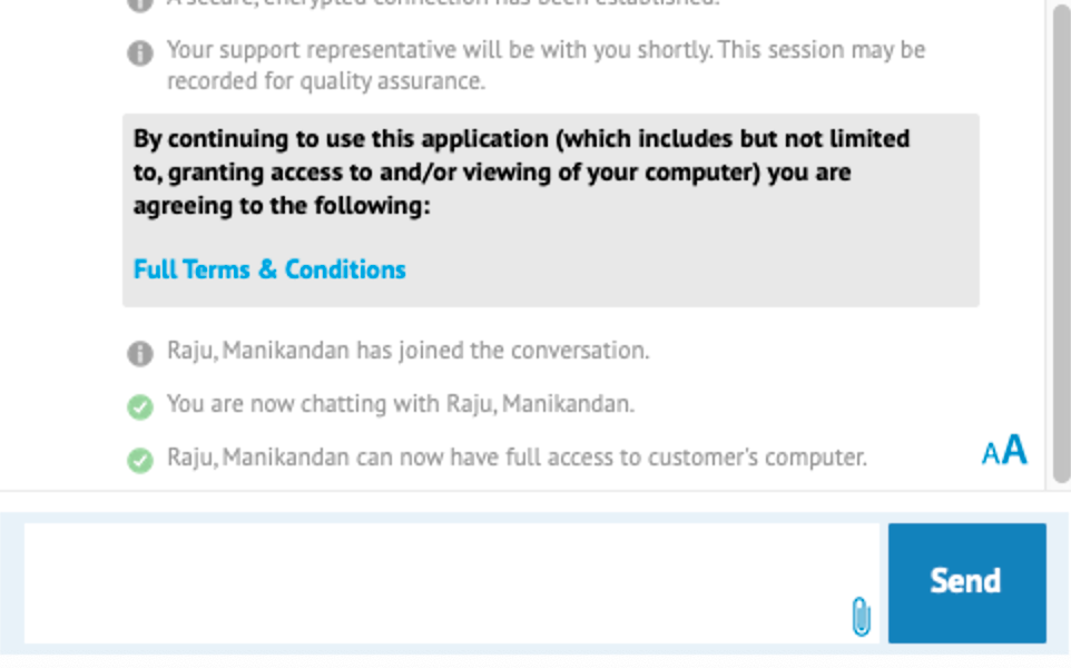

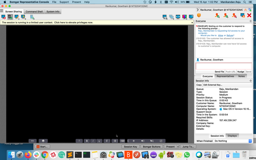

I'm getting the blank screen any idea about this issue.
observed issue when connecting to catalina machine only bomgar version 18.1.4 9eabad83a9a245f48534470cdb9772a1
dlondon
Hi @mani2care I've seen that blank screen. For me that means the user has not yet allowed screen recording.
At the User's end they will see a popup about Screen Recording. They must click "Open System Preferences" If they don't you will only see a black screen in your console. If they make a mistake and click "Deny" they can still go to System Preferences > Security & Privacy > Privacy tab > Screen Recording ... and tick the box for Bomgar. They do not have to unlock anything.
mani2care
I have tried all the options, screen recording was empty and not getting any pop up to allow or deny.
Allowed, accessibility and full disk access, file and folders tried with PPPC also having only denied options there.
i can access the terminal only:
ffc0d8aa7aa9445ea3cf66450426efcf
3625b486bdb948dbaa39ac73afa3c215
ab68e48287344e929630c6509e456a89
