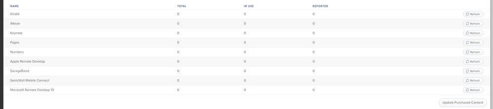

My total Licenses for my VPP accounts (Settings>Global MAnagement>VPP Accounts) are fluctuating from the expected number to 0
tons of this in my logs:
VPP License with adam id xxxxxxxxx has been transferred to a different VPP token
and in ASM:

Seeing this as well.
Also purchased apps are not being added to the "Mac App Store" list & on occasion:
